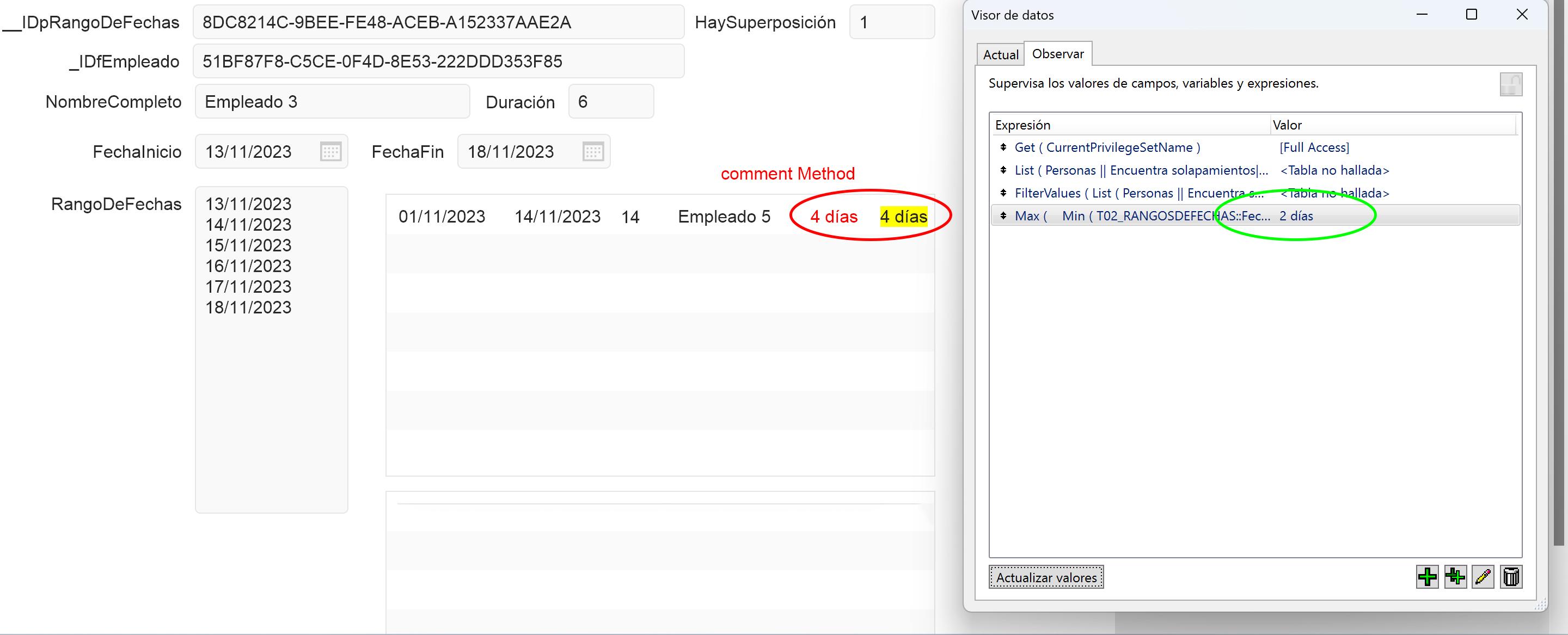

I’m trying to make work a calc field in a portal and I can’t figure out what am I doing wrong because not always shows the correct count of days (lack of knowledge must be key, for sure, lol).
Everything seems to work fine, except the field that counts the overlapped days.
I upload a demo file, I apologise it’s in Spanish but I’m sure it’s easy understandable.
Is it the relationship, is it the calc? I’m lost.

Could it be a bug or something? Because the data viewer shows the right calculation...
Most of the times the first row of the portal works fine and the issue happens in some other rows, but not always. Some other times happens in the first row of the portal too.

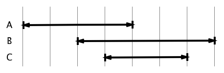

And I don't know how this could be done using a single calculation that compares two ranges. Suppose you have 3 employees with 3 ranges:
  • A and B overlap by 2 days;
  • B and C overlap by 3 days;
  • A and C overlap by 1 day;
What should be the result of the calculation, when performed from the context of A???
You seem to want to have the results displayed inside the portal - so that when A is the currently viewed record, the portal would show record B with an overlap of 2 days and record C with an overlap of 1 day. But records B and C do not "know" that you are currently viewing record A. The only way this could be accomplished would be to load the currently viewed record's dates into global fields (this could be done using a script triggered OnRecordLoad) and then have each record compare itself to this range.
