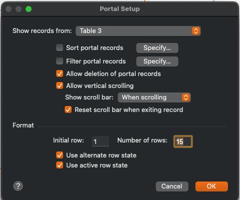

Isn't it portals you're talking about? Some portals can have "Reset scroll bar when exiting record" :
No, it's a plain table view. If I switch to form view and switch back, it doesn't do that.
