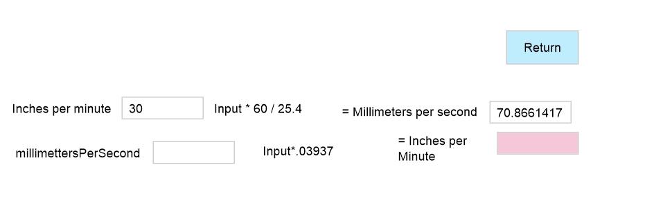

In this filemaker pro 12 file I have a layout #6 that I am trying to get this calculation to work that converts Millimeters per second to inches per minute.
I found a site that tells me how to do it and that screen capture is on that same page as my calculation attempts.  Can one of you kind folks nudge me back from my headache and show me the error of my ways on this calculation.
  • 1 minute = 60 seconds;
  • 1 inch = 25.4 millimeters.
So: multiply millimeters-per-second by 60 to get millimeters-per-minute, and then divide by 25.4 to get inches-per-minute:
Input * 60 / 25.4
That's all there is to it.

That worked perfectly.   Thanks Comment.
Would you have the calculation for this one?
To get Millimeters per second to convert to inches per minute.

I must have it backwards.   This is what I am working towards.
Input the inches per minute in one field then calc the millimeters per second.
Input the Millimeters per second in one field then calc the inches per minute.

The opposite calculation is of course:
Input * 25.4 / 60

If you are planning to allow the users to enter either millimeters-per-second or inches-per-minute, and convert one to the other depending on which one was entered, then see:
https://fmforums.com/topic/95234-overriding-calculated-values/?do=findComment&comment=436204
Although I believe a better solution would be to have them enter a value into a single field and then select the units in another field.

Your smarter than the AI program that gave me the first calculations.  I could take what you gave me and make it work and after figuring out I had it wrong was able to go in and fix it.  It's working great.  Thanks so much.
