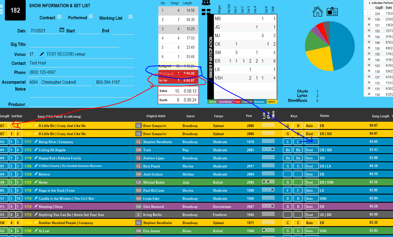

There are two single-row portals on my layout (stacked in orange).
The first one shows a count of records where no Set is specified in the related Performances table.
The second portal counts records in Performances where no Singer is specified.
I'd like to hide the portals entirely based on whether or not there are no records to show; so if the count is zero, just hide it because it's not helpful information. It's colored red to alert the user that a set or singer hasn't been assigned.
In the example below, the portal circled in blue has 1 record because there is a song in the list that doesn't have a Singer assigned to it.
In the second portal (circled in red) there is one song that doesn't have a Set assigned to it.

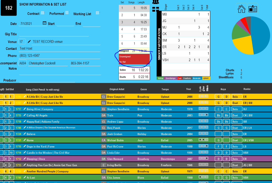

When I correct those issues, I get this, which is expected. I'd like to hid the text objects "Unassigned" and "No Set" as well as the red portals altogether. Any thoughts?

That makes no sense to me. If a text object is inside a portal and the portal is hidden, then the text object is hidden too. And also, if the portal has no records to show, then the text object will not be shown either.
