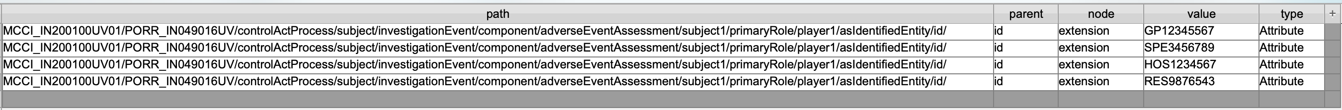

I'm using Jens Teich's XML to FMP (Drag n'Drop), which includes its own "Universal XSLT" to import XML. The resulting fields are named path, parent, node, value, and type.

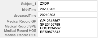

The XML file can hold information from 1, 2, 3, 4 or more Medical Records. I've added a calculation to capture each Medical Record Number - MRN
(Case ( path = "MCCI_IN200100UV01/PORR_IN049016UV/controlActProcess/subject/investigationEvent/component/adverseEventAssessment/subject1/primaryRole/player1/asIdentifiedEntity/id/" and parent = "id" and node = "extension" and type = "Attribute" ; value ; "" )
to find the relevant value and send it to the Summary field. The problem I have is that there is still some granularity missing to distinguish the Medical Record Numbers, as the calculation will bring multiple MRNs into the same Summary field (because the calculation criteria are the same for all MRNs, see attachments). I cannot anticipate the structure of the Medical Record Number (the example includes a prefix to distinguish if the MRN is from a General Practitioner, a Specialist, a Hospital, or a Research Study, but I don't think I'll be that lucky in a Real World Environment). This is happening with other fields that also have repeating path, parent, node, and type patterns (such as the patient's age, Adverse Event date, weight, and height).
I'm guessing that the "Universal XSLT" is missing a field that distinguishes what goes where and allows to send the values to the correct Summary fields.

OK, so I looked at the XML and there are two unique identifiers for the MRN, namely, the id root (last numbers ending in 7, 8, 9, and 10) and the <code code= (numbered 1, 2, 3, and 4). The id root 2.16.840.1.113883.3.989.2.1.3.7 is on the record prior to GP12345567.
Maybe there's a way of processing the XML file to go into XML to FMP (Drag n'Drop) twice? Once, in the usual drag n'drop fashion, while the second script copies the entire XML and places it into a "MyXML_pasted_into_a_field" (or maybe even a global) field. I'm probably chasing my tail with the following workaround but, a simple Let could do the trick for most of the field clashes, without going into XSLT hell. Something like:
