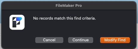

If a "Set Error Capture [On] is missing just before the first Perform Find[ .... will this show up occationally:

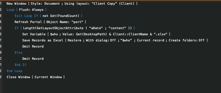

I agree it's not really worth it. But I came up with another approach to the matter, we could use filtered portals and picking variables for the scripting with GetLayoutObjectAttribute ( as well as the "Save as Excel" function on an extra layout stripped all irrelevant fields shown.
