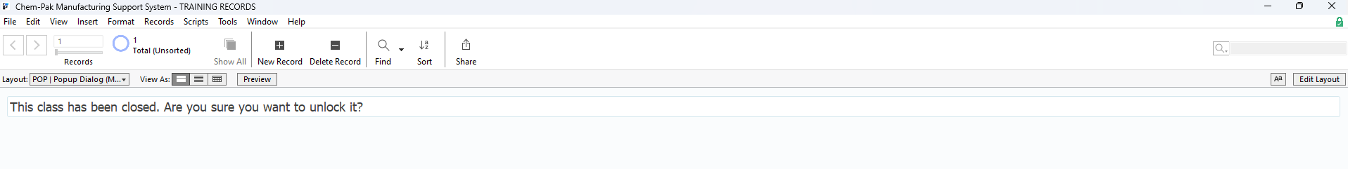

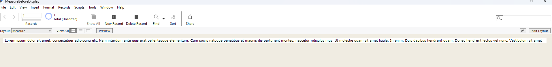

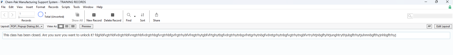

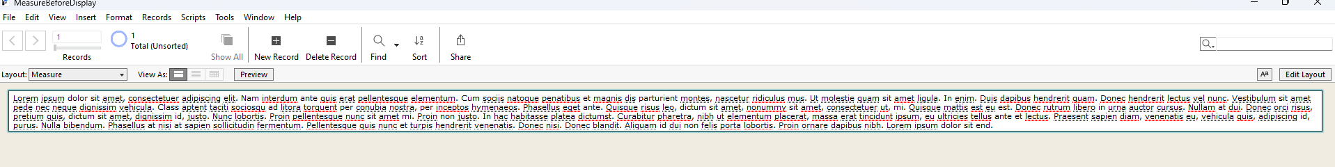

Go To Field in the MeasureBeforeDisplay solution by @comment makes the field enlarge as shown in screenshots 1 and 2. My field with exact same settings does not enlarge, but rather the text gets smaller (3 and 4). I wonder if that has to do with theme settings.
I don't think so. Can you reproduce this behavior in a new file, using the same theme? If so, please post the file (with 1 table, 1 field, 1 layout).
I'm using a custom theme, not sure how to reproduce it in a blank file. But I tried to use different stock themes and the field does resize fine, font size stays the same.
You can import it:
https://help.claris.com/en/pro-help/content/importing-themes.html
And yes, if your custom theme defines different font sizes for Normal and In Focus states, you will get the behavior you report.
