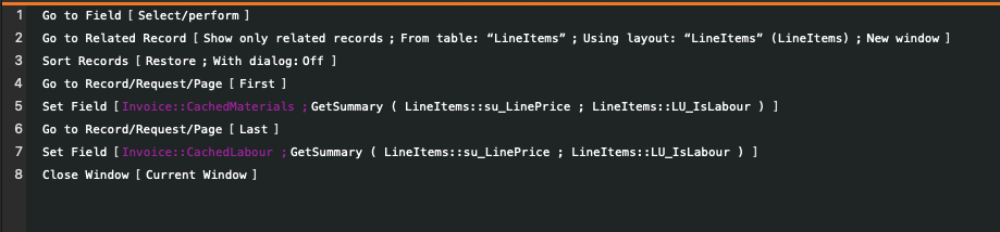

Under each modifiable field, could the developer establish the summary via "on modification" script trigger use the GetSummary( function to load a simple number field, instead of the Beverly Voth one-line portal. It's a spreadsheet'ish behaviour we're after here, which doesn't quite rhyme with the gist of relational databases ... I'm afraid. It could be said that "found sets" only exists in spreadsheets as such, never in SQL and only ....to a certain degree in filemaker. A developers vanity plays in here!
Something must be instated to prevent long chains of unstored calc's to update/adjust themself allthough it can be accomplished with some yawning ... and "grandparenting" relations fall into that category - am I afraid!
Clicking outside a field, is however often done scripted with: Go to Field[select/perform]
Thought provoking issues however exists in this: https://filemakerhacks.com/2013/07/28/forgetsummary/

Have changed the template I made som days ago ever so slightly:
InvoiceCached.fmp12
It's Michail Edoshins technique Fast Summaries in action here! But because only a binary value is used here would there not be need for counting summaries in order to jump from group to group, first and last record would here suffice!

13 hours ago, RSGC said:
Thanks to you both. I am not sure I totally have my head wrapped around all of this, but I have managed to make what I needed (wanted) to show up where and when I want.
The reason to choose the cached version of the matter here, is that you could locate orders where say more than 10000 labour hours is used, because you're avoiding to make searches  in  unstored fields which, both sum( and genuine summaries are.
Try to make a million dummy records, where both the sum( and summaries are shown as a result on the layout ... and learn that Filemaker can get a bad reputation, for not giving instant answers ... even thoug it's mainly down to the developers choice of tools to take the blame.
