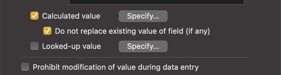

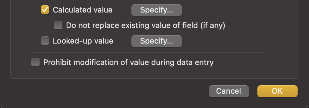

Mine is the same, but only the later, by being an autoenter - here is a certain snag to it:
Because if you later introduce a new stored calc-field, will it evaluate - despite not being there in the first place when the record is made. Auto enters will only trigger if the components it's made off are modified ... if it's introduced later than the arrival of the components, just as Barbara said.
