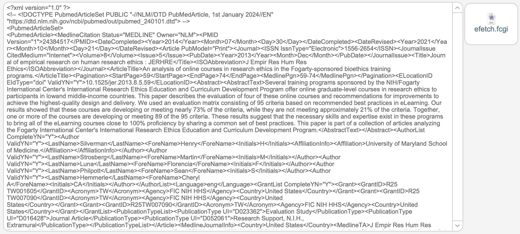

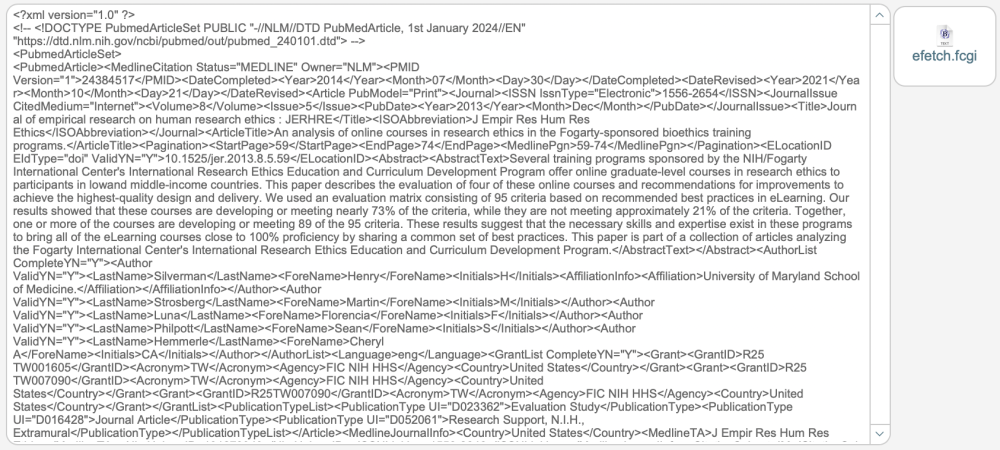

Strip second line from XML prior to processing
Using Insert from URL, the result can be:
1. Downloaded as text into a text field (in XML format).
2. Downloaded as a text file into a container field, also in XML format, with a generic file name (efetch.fcgi).
The tricky part is that the second line contains the DOCTYPE. When FileMaker reads this line, it spends up to twenty seconds there, and then progresses with the script. As there are many XSLTs, FileMaker reads the DOCTYPE that many times, extending the entire process to way over 3 minutes or so.
If I manually remove the second line, the entire processing time goes down to the expected 1-2 seconds in total.
In 1., I've commented out the second line with a calculation, but I haven't been able to get the script to recognize the calculated text as XML and use that modified XML to process with the XSLTs.
In 2., I don't really know if I can modify the contents of efetch.fcgi from within its container field.
What would be the best way to do this? Would both cases requiere the modified XML to be downloaded and reuploaded?
Do you mean during the import? After you have exported/written the field's contents to somewhere on your hard disk?

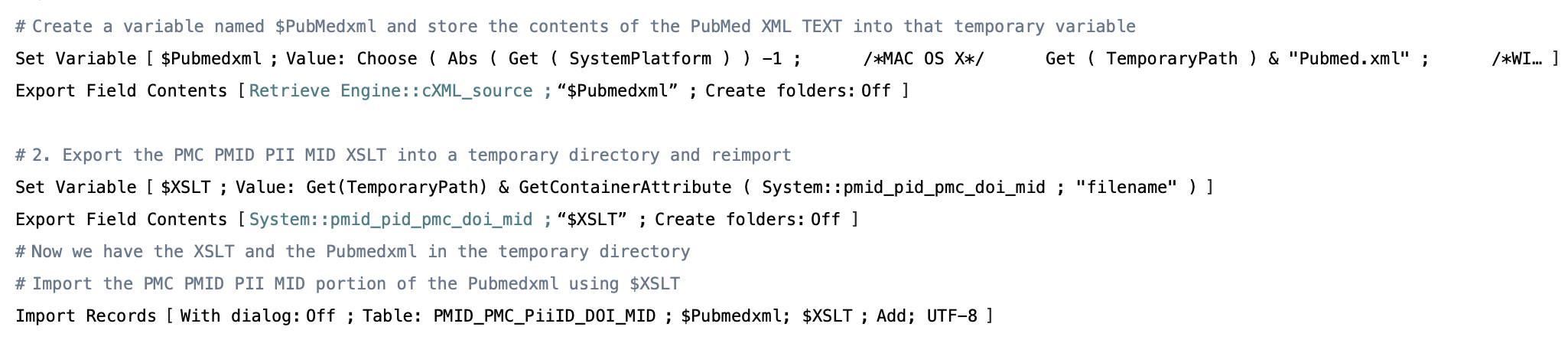

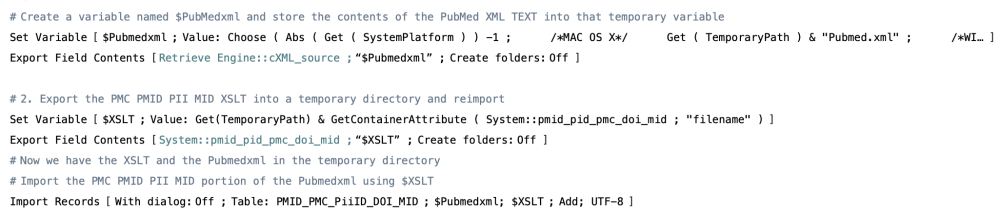

OK, so it's taken me 20 days to progress to a promising, yet non-working script:
Inside the first line is:
Choose ( Abs ( Get ( SystemPlatform ) ) -1 ;      /*MAC OS X*/      Get ( TemporaryPath ) & "Pubmed.xml" ;      /*WINDOWS*/      "filewin:"& Get ( TemporaryPath ) & "Pubmed.xml" )
cXML_source contains a Substitute that removes the second line from the XML (the DOCTYPE with the DTD).
Import fails with a [719] Error in transforming XML using XSL (from Xalan).
We don't see this part, so we don't know if it does what you claim or causes a problem. Nor do we see the XSLT.
I would suspect that one or both files contains an XML declaration like:
<?xml version="1.0" encoding="UTF-8"?>
but since you are doing Export Field Contents for both, these files end up being encoded as UTF-16. But that's just a guess.
Hi, Comment,
The contents of the cXML_source are:
Substitute ( XML_source ; [ "<!DOCTYPE PubmedArticleSet PUBLIC \"-//NLM//DTD PubMedArticle, 1st January 2024//EN\" \"https://dtd.nlm.nih.gov/ncbi/pubmed/out/pubmed_240101.dtd\">" ; "<!-- <!DOCTYPE PubmedArticleSet PUBLIC \"-//NLM//DTD PubMedArticle, 1st January 2024//EN\" \"https://dtd.nlm.nih.gov/ncbi/pubmed/out/pubmed_240101.dtd\"> -->" ] )
If I import the XML using the XSLT from the File/Import Records/XML Data Source, it performs flawlessly. So, it has to be something wrong with the script.
The XML contains the following declaration:
<?xml version="1.0" ?>
Your assumption is correct. The XSLT states the "utf-8" encoding, twice. AFAIK, "utf-16" is necessary for asian languages, but otherwise, I don't understand the implications, nor how to correct the script. Maybe I have to force the use of "utf-8" during the download?

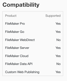

3 hours ago, Quito said:
Does the Write to Data File function for both local and server use?
Yes.
FYI, every script step help page shows a compatibility table like this:
In addition, you can see which script step are server-compatible by selecting "Server" from the compatibility menu in the top right corner of the Script Workspace.

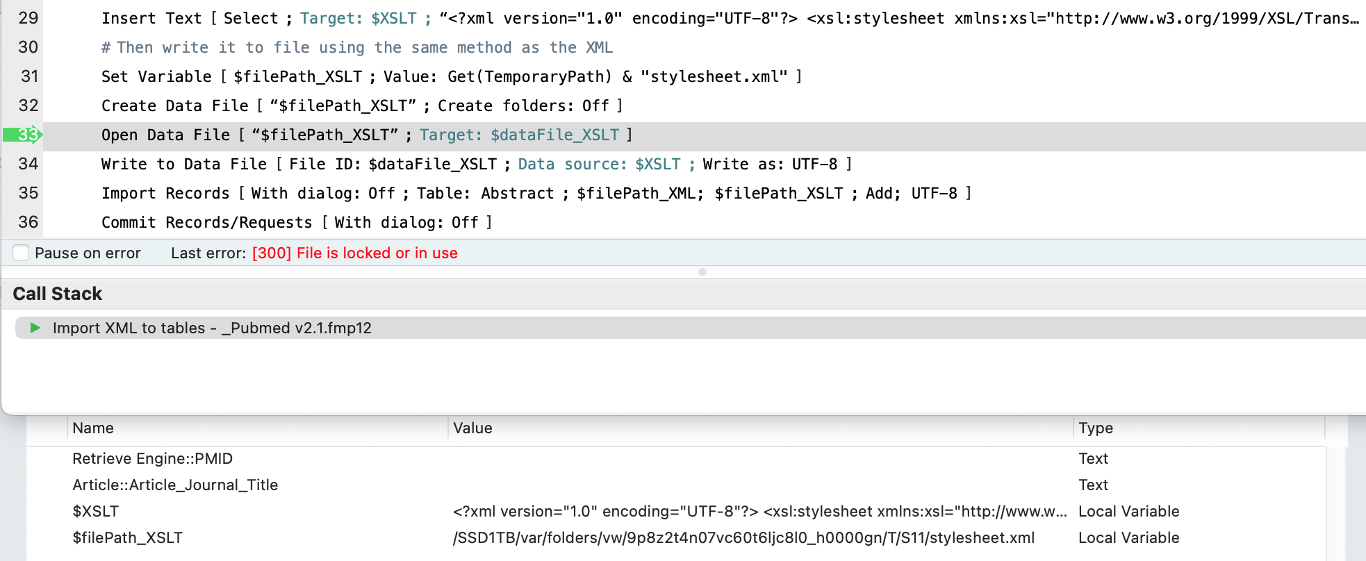

I don't know, because I am not able to reproduce the problem.
See what happens if you pause the script for a second before trying to open the data file.
And you certainly must close the data file after writing to it, before you attempt to use it in the import.

Following your advice, after making the script a bit more legible, and adding Close Data File, the script progressed successfully:
Insert from URL [ Select; With dialog: Off; Target: $Pubmedxml ; "https://eutils.ncbi.nlm.nih.gov/...
Set Variable [ $Pubmedxml; Value: RightValues ( $Pubmedxml ; ValueCount ( $Pubmedxml ) -2 ) ]
Set Variable [ $filePath_XML; Value: Get (DesktopPath) & "pubmed.xml" ]
Get File Exists [ "$filePath_XML" ; Target: $fileExists ]
If [ not $fileExists ]
Create Data File [ "$filePath_XML" ; Create folders: Off ]
End If
Open Data File [ "$filePath_XML" ; Target: $dataFile_XML ]
Show Custom Dialog [ "File ID" ; "File ID for " & $filePath_XML & ": " & $dataFile_XML ]
Write to Data File [ File ID: $dataFile_XML ; Data source: $Pubmedxml; Write as: UTF-8 ]
Close Data File [ File ID: $dataFile_XML ]
In time, the DesktopPath will change to TemporaryPath.
Now I'm getting a 719 error (Error in transforming XML using XSL) when parsing the second stylesheet, but that's for another topic.
