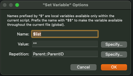

In the second template in the above thread - why are you using the repetitions in the setting of the variable?:
I think I accidentally left an unused script there. In some previous version there was a variable for each record so that you could browse the parent table and have the portal follow.

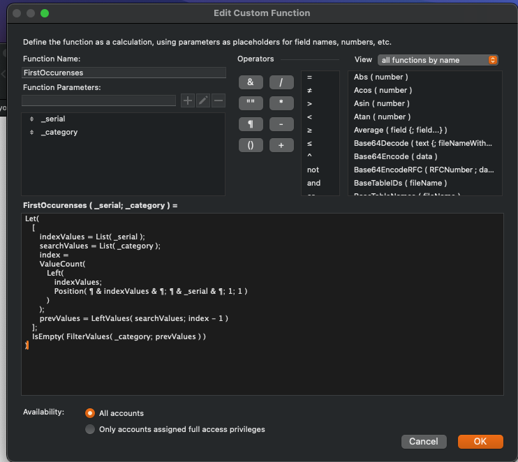

I have custom-functionalized the filtering-calc, since it's already required twice:
Portal_Unique_11a.fmp12
