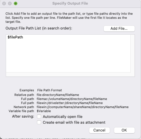

I have been looking into this and feel that in might be to do with the file path that the PDF is saved to and the iMac either not having permissions to save to this on the host or it can not save over the network and should be saved locally.  I just don't know how to change that only on the iMac.
Currently the out put file path is listed as $filePath.  If I add filemac:/volumeName/directory/filename below that (with correct info for the iMac) would this work, and if so, what is the filename meant to be?

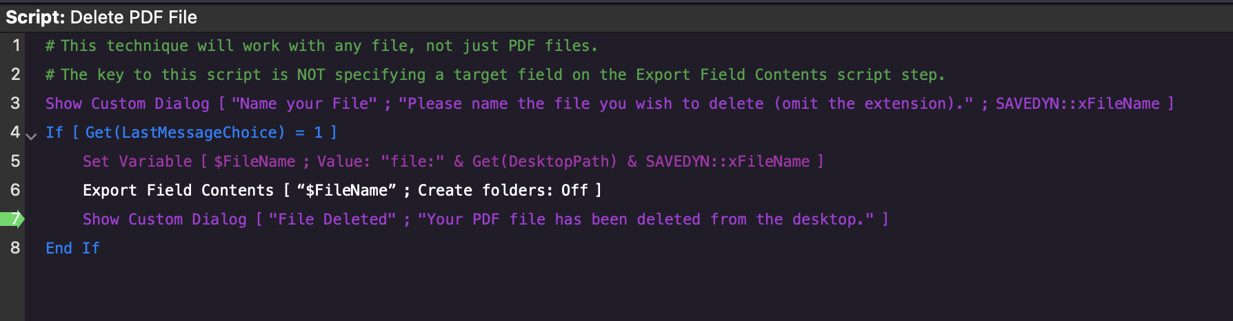

Secondly, for storing pdf's use something like:
But if you use say your desktop as temporary location for the pdf, your'e working with - should some housekeeping be done, here's how with a tip, from: https://databasepros.com/list.php?resource_id=DBPros000819 - the script goes like:
Edited by Søren Dyhr
 To be honest, I have no idea where the PDF file is saved or if it even is.  I run the script and the PDF appears in the body of the email, and I send it - if they are saved somewhere else prior to that, I really don't know.   As you may be suspecting by this point, I am not a filmmaker expert 🤪 I use it because I need to, so do appreciate any help - just type really slowly...

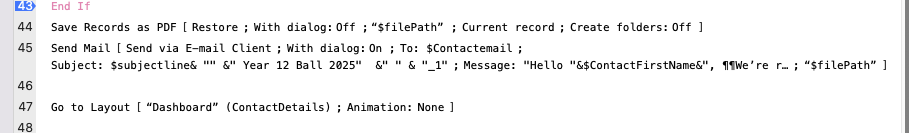

Ok, so it seems determined to not let me copy or print/copy paste that bit so here is a screen grab
Edited by Craig_ST

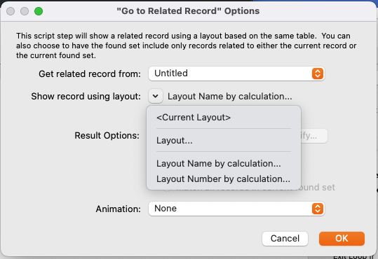

Well here is at least one, I would suggest that you every time you fire a GTRR(FS) checks if you have arrived as expected ... Then is all the layouts seemingly the same table occurrence group, then would a single GTRR(FS) suffice, and  then use a calculation as to which layout to land in:
Say you have one layout to use, when just one record is in the found set - and then yet another when there is two to display, and finally a third layout for showing multiple records. You could use following script to address these 3 cases, this way:

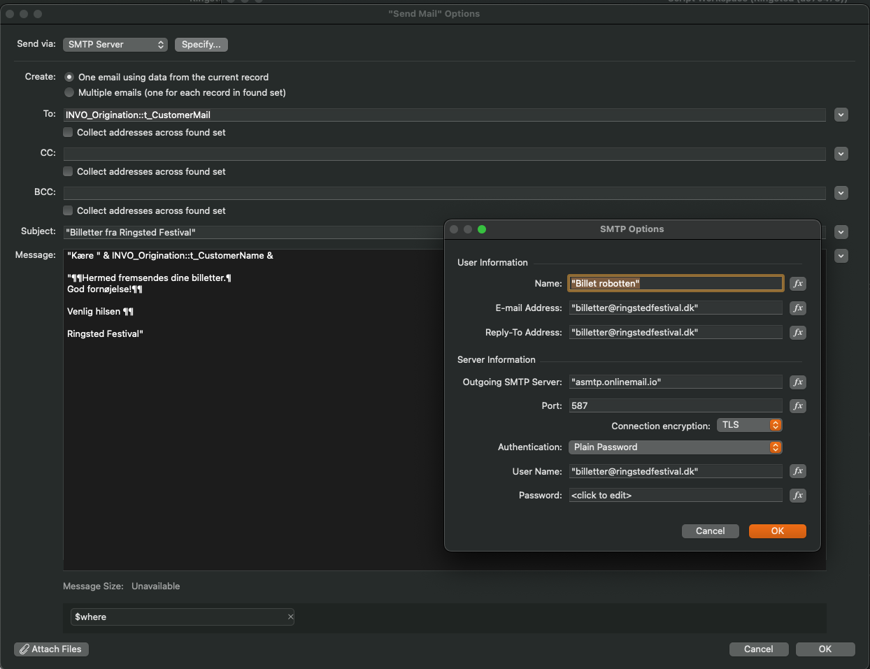

If using SMTP, will I have the opportunity to make client specific alterations to the the email before it is sent, as this is a must for us.
Yes it's a calc field:

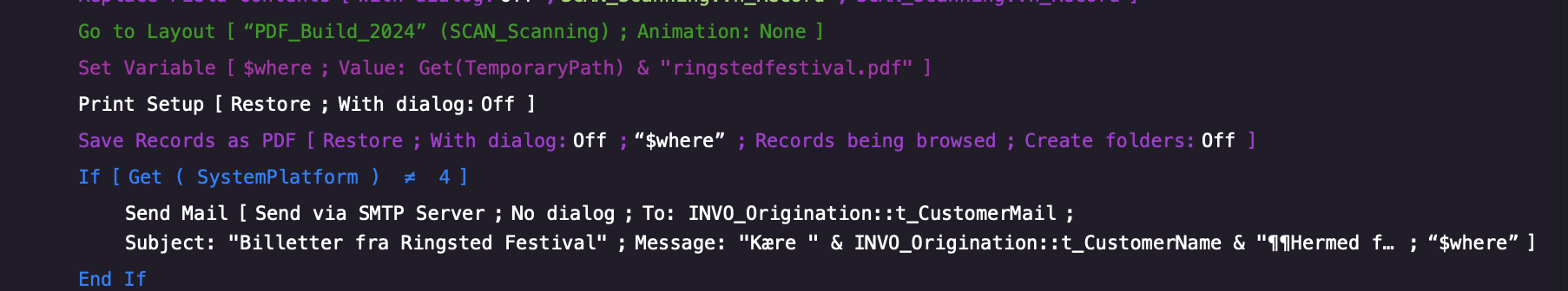

...heres what I've done at some time, down in the button saying $where ...am I attaching the pdf. Although font size and color won't work as expected - if's too limiting then go the plugin way of doing this!
