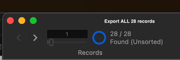

I've duplicated a test file on my Mac using the Option and drag method for convenience. Below are the steps I've outlined to better explain the process:
1. Open the original test file and navigate to File > Export Records to export all 28 records. Refer to the included screenshot for guidance.

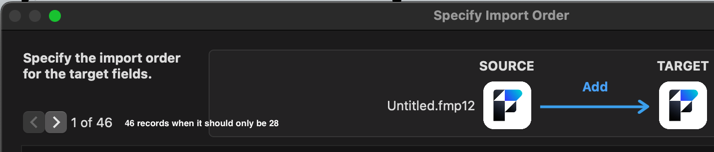

5. Return to the top Menu bar, and go to File > Import Records > File. Locate and select the exported file named "Untitled" and click Open. Choose to "Add source data from selected fields as new records in the target table."
6. In the "Specify Import Order" window, on the left side, it should display 1 of 46 records. However, since only 28 records were exported, this number should be 28. Refer to the provided screenshot. Click Import at the bottom right. Afterward, an "Import Summary" window will appear indicating that 46 records were added. Click OK, but note that there are 18 records with missing information, which is unexpected.
This discrepancy is confusing as to why the imported record count does not match the expected 28.

I still don't follow the plot. You say you exported records to a file named Untitled. Then deleted all records in this file. And now (in step 5), while you're still in this file, you want to import records from a file named Untitled? This cannot work because (a) there are no records in this file, and (b) this file has only one table and you cannot import a table to itself.
Is it possible you have another file named Untitled and you are importing from there?

All I can say at this point is that the problem cannot be reproduced using your description. And I am not going to entertain wild speculations regarding what might be missing from your description. There's probably a very simple explanation right under your nose (https://en.wikipedia.org/wiki/Occam's_razor).
I am also not sure what is the point of this elaborate exercise. If you want to make a copy of your file without any records, you can simply save it as a clone (no records). That's one step instead of your steps 1 to 4. And records can be imported directly from the source file, without exporting first.
Note also that when importing records manually, you can see in the left pane of the Specify Import Order dialog how many records are in the source table and you can step through them and examine the data in each field of every record.
