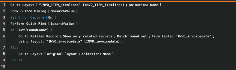

You'll go to a layout of the tables content shown in the portal, make a request there - and then do you go backwards from the child records found, to it's parents via GTRR - Here is a search made like ... give me all invoices where the item XX is present in the itemlines:
... where the crucial point being "Match found set" in line 6 of the script.

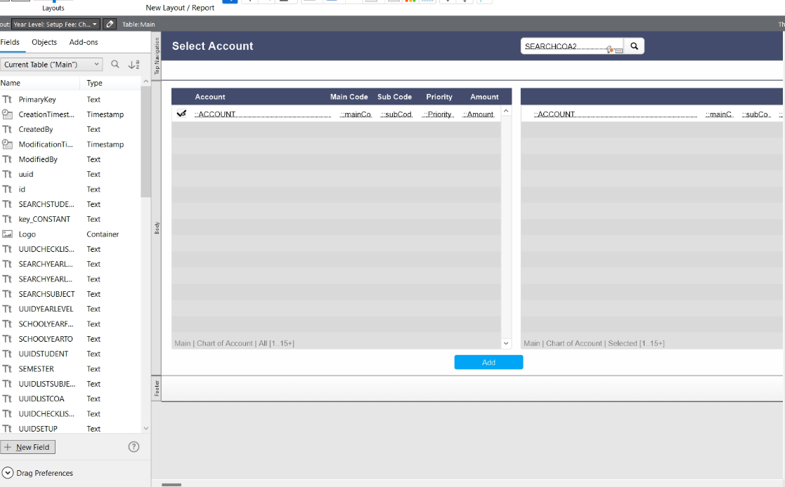

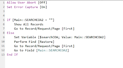

Here is my table that i want to create a search function. I have a variable field in Main table. and also here is my script. But it is not working.
When I search for any text that isn't in the portal, the portal empties. However, when I search for a specific account name, it doesn't appear.
What could possibly be wrong with my work here?

You should go to a layout of the table occurrence called Main | Cart of Account | All ... which apparently is a relation away?
... this seems like it's not a relation away, but a portal of the current table? But why is there these two "::" in front of the Account in both portals ... wouldn't a cartesian related selfjoin portal be better for the left portal, and then use the current table portal to the right?
2 hours ago, Mark Gimpaya said:
how to create a script that finds or search a record in a portal?
That is not a clear requirement. A portal will always show all child records that are related to the current parent record (except records that have been filtered out by the portal's filter), regardless of the current found set in either table.
You can specify a related field when performing a find. In such case, Filemaker will find records in the parent table that have at least one related child record that meets the criteria (and continue to show all related records in the portal).
If you want something else, please clarify exactly what it is. Posting a script that does not do what you want does not explain what you do want.
From the screen shot, I’d suggest a list detail layout.
