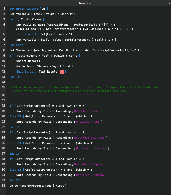

Indirection with sorting?
In another thread have I stumbled over something which I probably could pull off via Applescript, but it's lack of being cross-platform'ish makes me wonder if I'm forgetting something?
I could not say if the scale of records would allow me to transfere a copy the field in question to a specific sort field - in which the sorting then is performed in?

The only method I know of to sort records by a field that's not hard-coded into the script step is to loop among the fields until:
Get ( ActiveFieldTableName ) & "::" & Get ( ActiveFieldName ) = Get ( ScriptParameter )
then do Sort Records by Field [] without specifying a field.

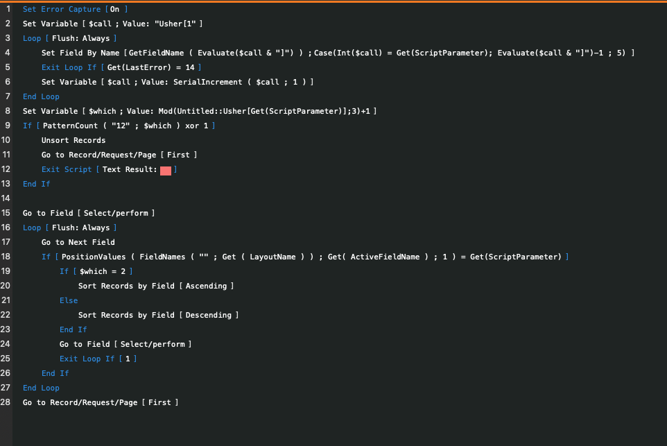

I went with this one, by utilizing Bruce's custom function: https://www.briandunning.com/cf/1167
However there might still be something in need of tightening?
I don't see why it's necessary. You can simply pass GetFieldName ( ... ) in the script parameter and compare it to the current active field as shown above.
Just because the script parameters where given a number in the template ... that's why!
....but you're right the scriptparameter could be more "saying"
Even so, what you're doing seems wrong to me (if I read it correctly).
You are calculating the position of the current field's name in FieldNames() and comparing this to the script parameter.  But the contents of the list can change as you add or remove fields on the layout, while the script parameter remains hard-coded.
I have been giving it some thoughts, and would probably reverse the logic, and make the buttons scriptparamter be a singeled out from the list instead:
Getvalue(Fieldnames() ....
But unfortunately the scriptparamter is here used for other matters as well, flicking the icon in the each button.
But which value would you get??
I see no problem passing multiple values, using either a return-separated list or JSON.
Neither do I 🤪
