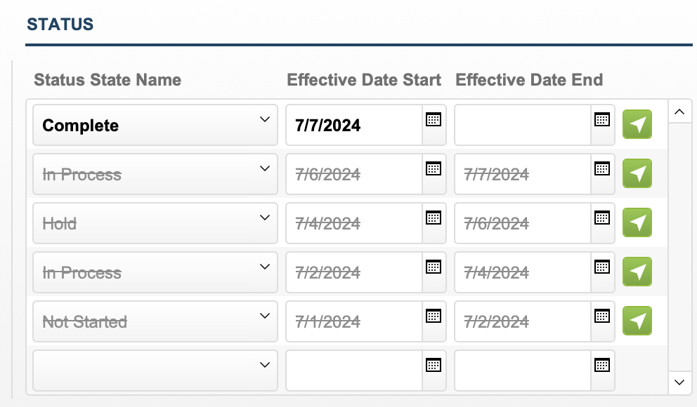

A project will NOT have more than one status at a time. However, there can be GAPS - if I understand you correctly. I am attaching a screenshot of a make-believe progression of statuses.
I don't see any gaps in the example. Every status begins on the same date that the previous status ended. That means you have unnecessary duplication of data, and this exposes you to update anomaly.
I wholeheartedly admit that this is an area I have struggled with.
I thought I needed an "end date". I will remove it and see if I discover some requirement for it.
After looking at Soren's file, I noticed he used TimeStamp in order to differentiate the fact that statuses CAN be changed multiple times a day. So, my use of just a Date is insufficient actually. I will change this to TimeStamp to allow the sort to accurately reflect the progression during any particular day.
As for the two tables - I am stumped on both your view and Soren's view that perhaps two tables are not needed. If I highlight the fact that I need to store the "progression" of statuses that a particular project has gone through, in other words, the history of a Projects status cycle — does that make a difference in your view regarding two tables? I still believe I need two tables.
