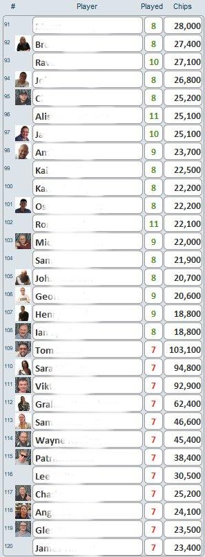

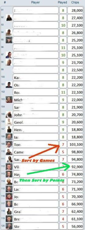

I have included a screenshot.

Thanks Comment,
The reasoning behind this as you can see from the screenshot, is Players who are close to qualifying are not in Game order they are in Points order (so all Players who have played 7 games are not in the correct order), Can I create additional an field in that table based on Games, so that I may sort with this field last?
I am still struggling to understand what is it exactly that you want. Are the players that do not qualify supposed to be sorted differently from those that do?
Thanks Comment,
Exactly.
Players that have played 8 or more games are sorted,
First by your suggestion - Add a calculation field to the portal table (result is Number) = greater than or equal 8,
Secondly by Points and
Thirdly by games,
whereas Players who have not played 8 games are sorted by Games and then Points.

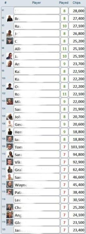

Thanks Comment,
Excellent solution, I will also try rolling them into one field at a later date.
Screenshot attached.
Regards
Milky.
