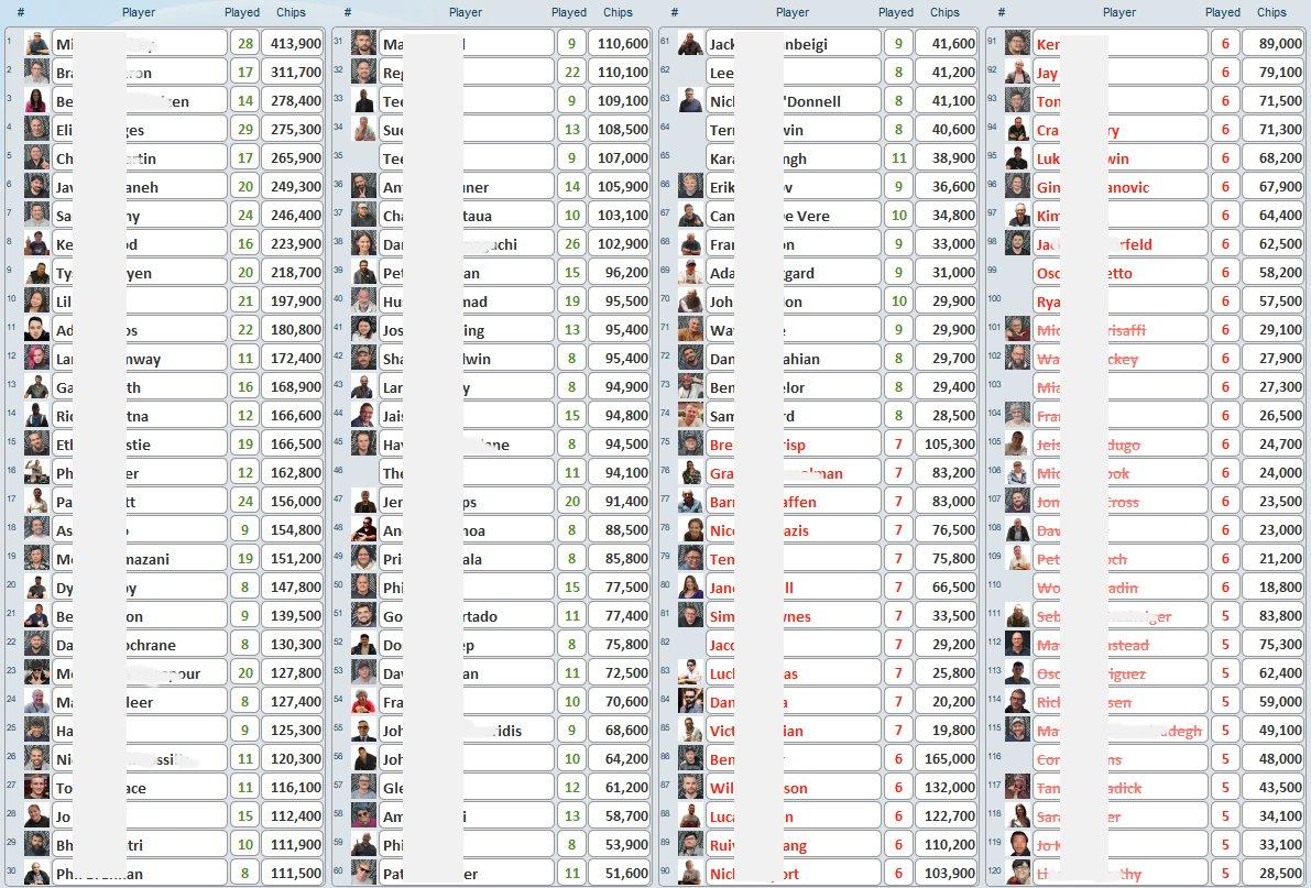

Is it possible to create a conditional format condition based on the portal row number?
In essence I would like to use the strikeout format for any portal row that is over 100.

Not directly, but still possible. You need to define an unstored calculation field (result is Number) in the chid table =
Get ( RecordNumber )
Then use this field in the conditional formatting's formula.

Thanks Comment,
Exactly what I needed.
It is used for a static display so users can see where they sit on the leaderboard, so they don't actually use the portal itself. (see below)
Regards
Milky
