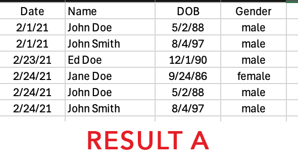

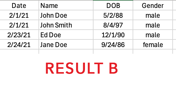

I would like to constrain records to only show 1 occurrence of an individual within a found set of records. (see pics for example).I perform a find by date range on table which produces result A. Now I want to constrain that set to get result B.
ie.. If John Smith shows up twice within that date range I want to constrain to only a single record for John Smith.
The idea is produce a report of Unduplicated Individuals Served within a date range.

My search table is Attendance. I needed to use the People table which should only have a record for a single individual (Primary Key) as my starting table to filter search results on the Attendance table.I was applying the incorrect logic to the issue. Started with a result and trying to work backwards to filter.
