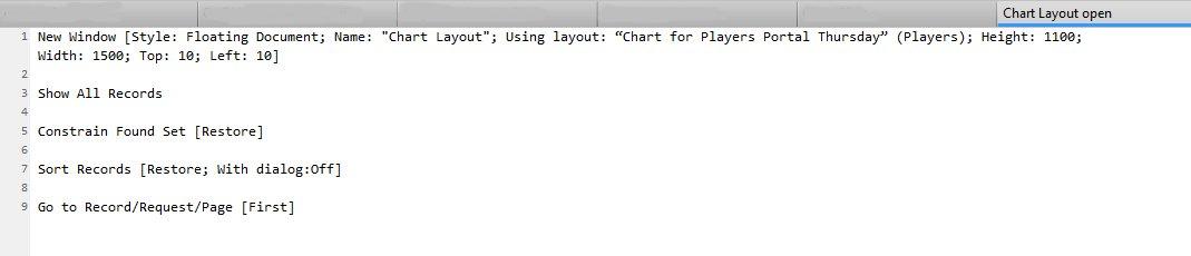

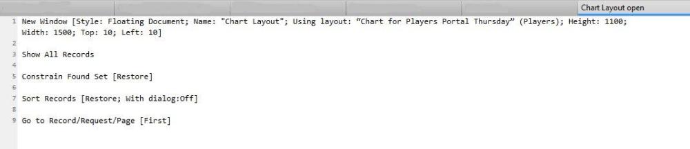

New Window using Layout, Show All Records, Constrain Found Set, Sort Records, Go to First Record, Preview, Save as PDF, the correct Folder on my One Drive appears, I use options to specify 1 page and click on a current file to overwrite.

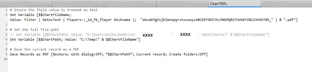

I then created a script as per the attached image, named Chart Layout Open. This works correctly.

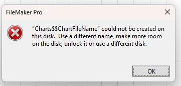

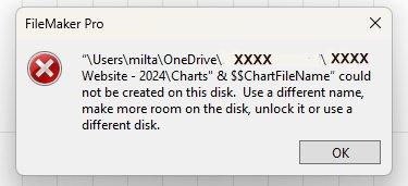

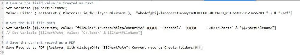

When I am on that Layout I select another button that runs the script as per the attached image, named Chart PDFs and I receive the following error message as per the image attached, named error message.
I have also tried not using One Drive in case One Drive is the problem and saved to C:\Temp\ which returns the same error message with the file path changed to C:\Temp\

You need a Filemaker path, not a Windows path - see: https://help.claris.com/en/pro-help/content/creating-file-paths.html
See also: https://help.claris.com/en/pro-help/content/convert-to-filemaker-path.html
A few other points:
  1. A backslash before a quotation mark escapes the quotation mark.
  2. Showing all records and then constraining the found set is an inefficient way to accomplish something that can be done simply by performing a find.
  3. Do not use global variables (prefixed by $$) where script variables (prefixed by $) will do.

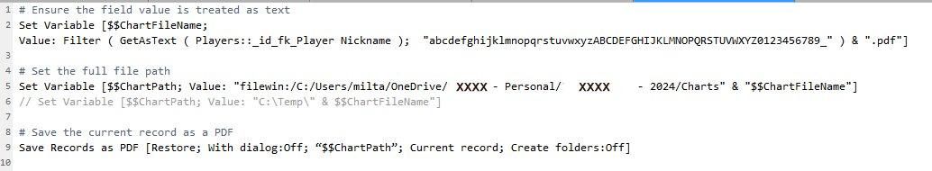

Thanks Comment,
I altered the path to a FileMaker path as per the image below, but I am still getting an error message.
I believe you are missing a / character at the end of "... 2024/Charts". And you should not be quoting the variable name.
There are others factors that could be causing the failure, which we cannot see. I presume those XXXX parts are hiding sensitive data, but it could be that the path to the Charts folder is incorrect. And we don't see what's in the Nickname field. I also wonder what type of field is the Nickname field and why do you think it needs to be converted to Text.
P.S. Please try to post your code as code, not as pictures.

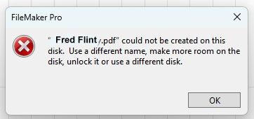

Thanks Comment,
I added the / and deleted the quotes and received the error message below (persons name altered to Fred Flint - the actual file is present in the Charts Folder and works when I carry out the task manually).
I have included the code as it is written with actual folder names etc:
#Ensure the field Value is treated at text
Set Variable [$$ChartFileName; Value: (GetasText(Players::id_fk_Player Nickname); "abcdefghijklmnopqrstuvwxyzABCDEFGHIJKLMNOPQRSTUVWXYZ0123456789_" ) & ".pdf"]
#Set the full file path
Set Variable [$$ChartPath; Value: "filewin:/C:/Users/milta/OneDrive/Toowong - Personal/Toowong Website - 2024/Charts/" & $$ChartFileName]
#Save the current record as a PDF
Save Records as PDF [Restore; With dialog off; “$$ChartPath”; Current Record; Create Folders:Off]
