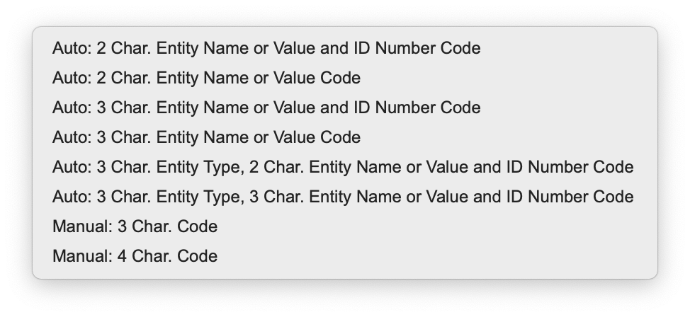

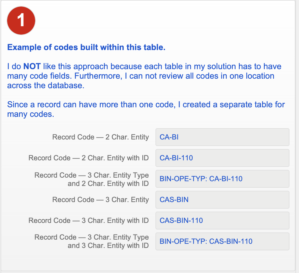

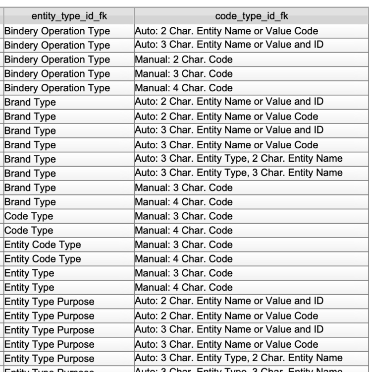

Screenshots show:
  1. Custom Functions
  2. "Entity Code Type" join records
  3. Calculation Fields - within the same table (what I can do, but do NOT want to do this in each table)
  4. List of Code Types
  5. Scripts involved via Script Triggers

I have chosen these Entity Types as sample material because they are relatively simple and easy for me to strip out of my database. I could have just left one Entity Type, but leaving a few others can show what I have done in terms of calculations shown on each layout.
On the layouts of these Entity Types, I do show the codes being calculated with Custom Functions. I made the Custom Functions together for consistency purposes.
What is important is showing the fact that these are fields specific to each Entity Type - which is what I do NOT want. This is an obvious case of needing an Entity Type to contain MANY codes for an Entity. So...

I have another Entity Type to differentiate the different Code Types that I want to select from in order to apply the Code Type "recipe" to a particular Code. That Entity Type is called:
  • Code Type
In order to constrain which Code Types are applicable to an Entity Type, I created a join Entity Type called:
  • Entity Code Type

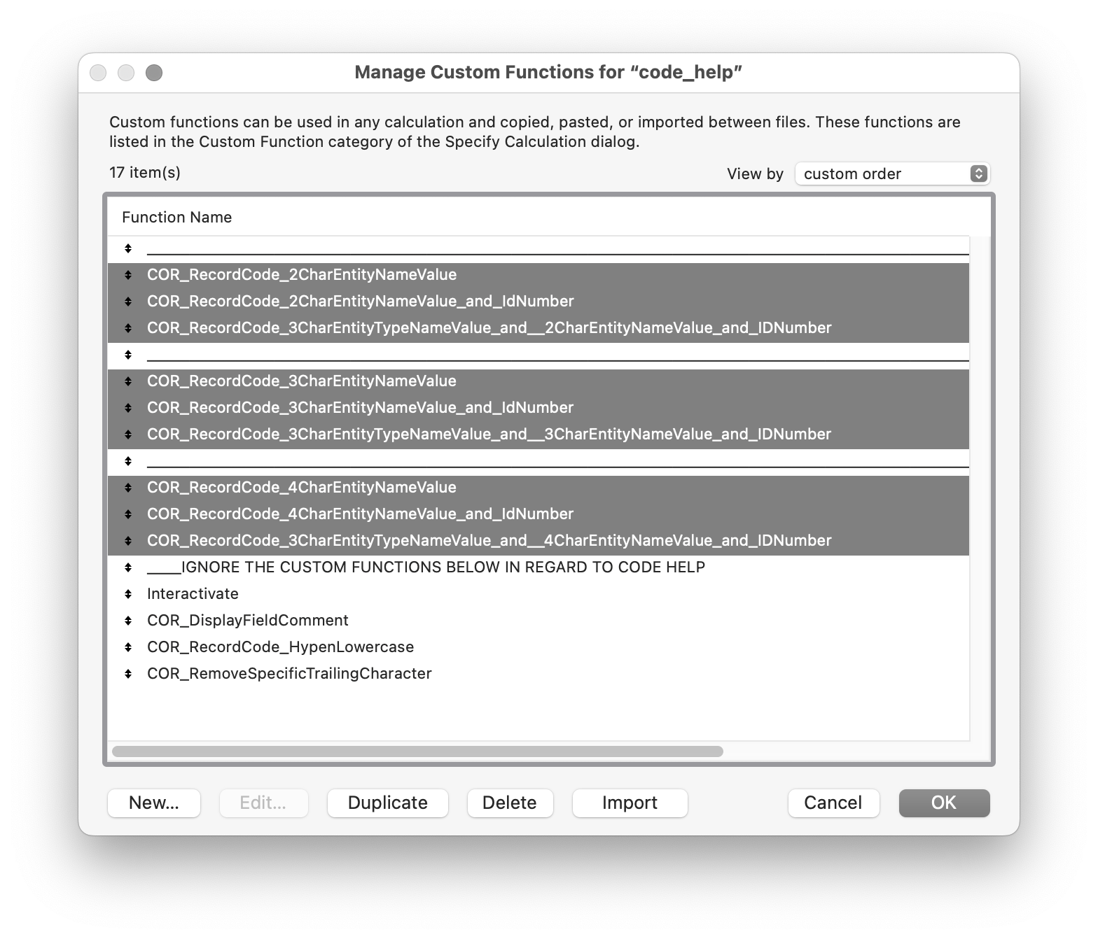

Custom Functions:
I created 9 Custom Functions. The calculations work for my example, however, I am sure the code I created can be optimized or better written, etc.

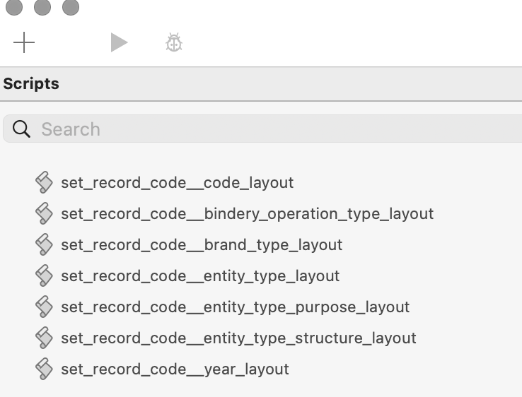

Scripts (triggered)
I created 7 Scripts to just "display" some result in my target field. I figured out how to get a hard-coded test result in the target field, but can not figure out how to get the Custom Function result in the target field.
Right now, I had to create 7 essentially the same script, but with subtle differences. I really would like one script that branches according to its use location. I thought if I could get one script to work - I could then try and figure out how to combine in one script.
If I could get some help on this I would greatly appreciate it!
