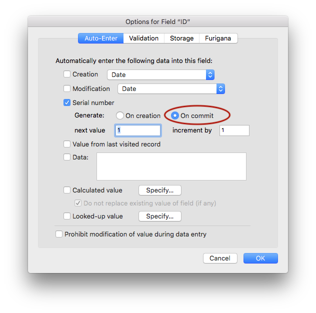

5 hours ago, MonkeybreadSoftware said:
You need to know that on record creation, the client will request a new serial number from the server. If the record doesn't get committed or gets reverted, the serial value is used, but no record saved. If you like to make sure the serial number doesn't get lost, please call Commit script step after creating the new record to make sure the empty record is definitely stored.
The same thing will happen in a local file. But the proper solution is to define the field to generate the serial number on commit only:
This way you can still revert a new record while keeping an unbroken consecutive series of serial numbers.
Please consider moving to UUID numbers instead
That's not a solution when you do need serial numbers (for example, in some jurisdictions invoices are required to be numbered serially).
Thanks for pointing out the option with creating serial on commit.
And for your invoices table, I have to say that primary key should not necessarily be the invoice ID.
Invoice IDs here are often defined as built from year, month and counter within the month, so we calculate them in the script.
