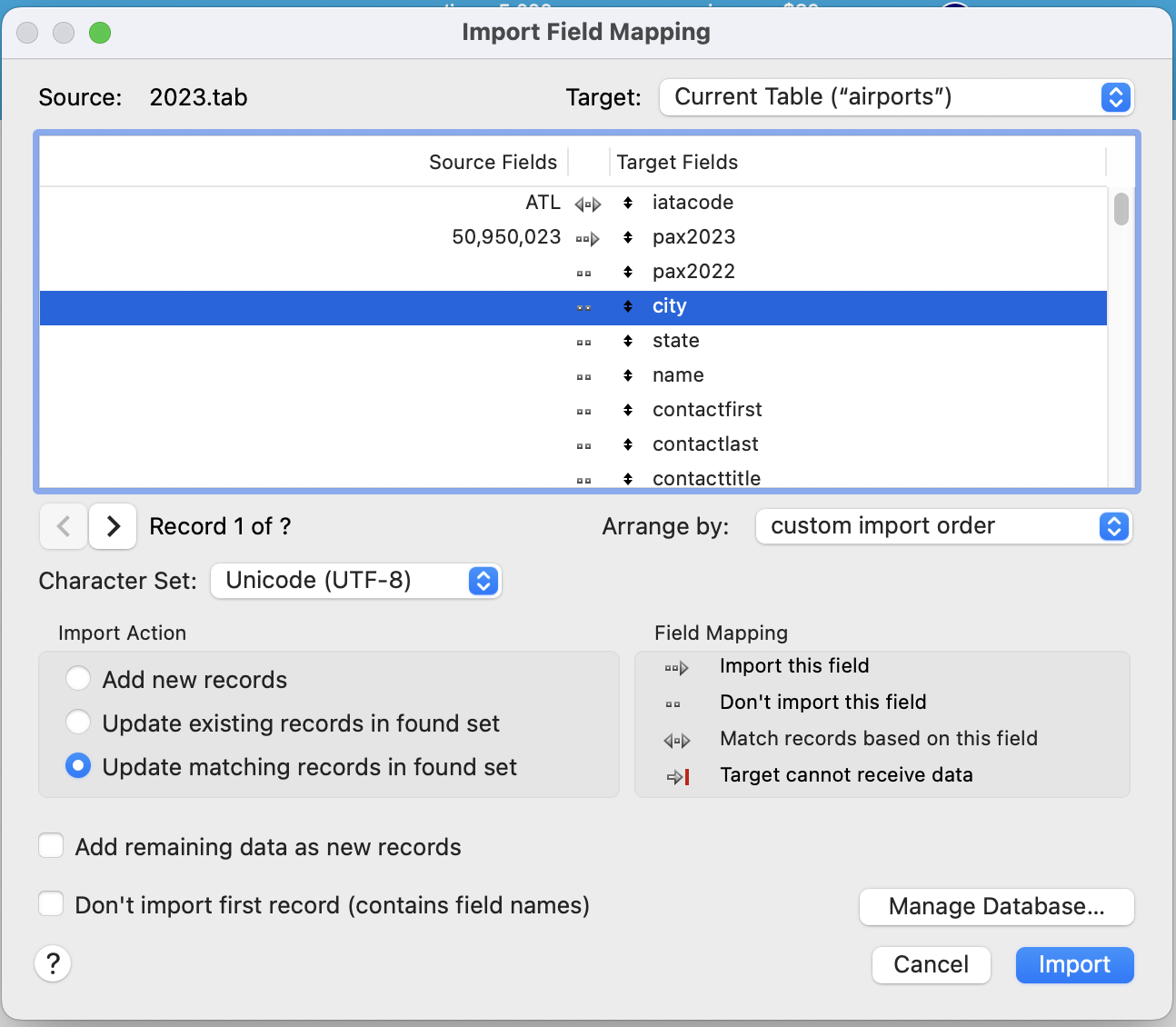

I have a database of US airports, identified by their three-letter IATA codes (e.g. JFK, ATL, ORD, LAX, etc.). The database includes enplanement information provided by the FAA. I set this up in 2021 so I included the latest year available of this data, 2019. The FAA has just published 2023 data and I want to import that, but my import doesn't work.
I've set up a tab delimited file with column A = IATA code and column B = emplacements. My original database has 512 records.

3. I select the tab delimited file and get the import field mapping dialog (screenshot attached).
4. I select Update matching records in found set.
5. I click on the arrow next to iatacode to "Match records based on this field". The two-headed arrow appears.
6. I leave the "Add remaining data as new records" box unchecked
6. I click on import. I check Perform auto-enter options while importing, then click Import.
7. I get this result:
