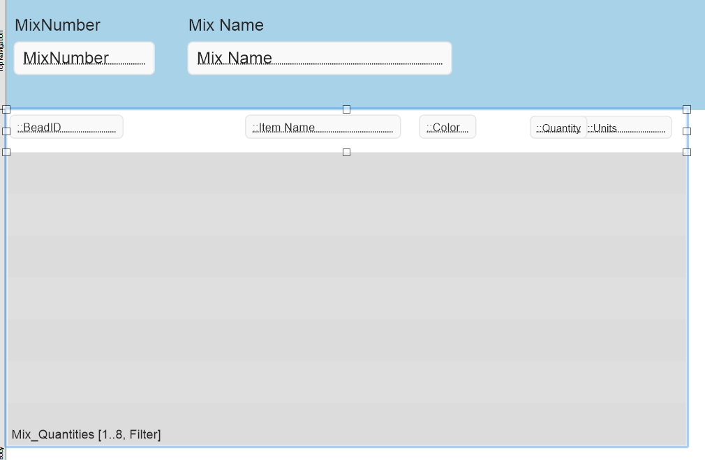

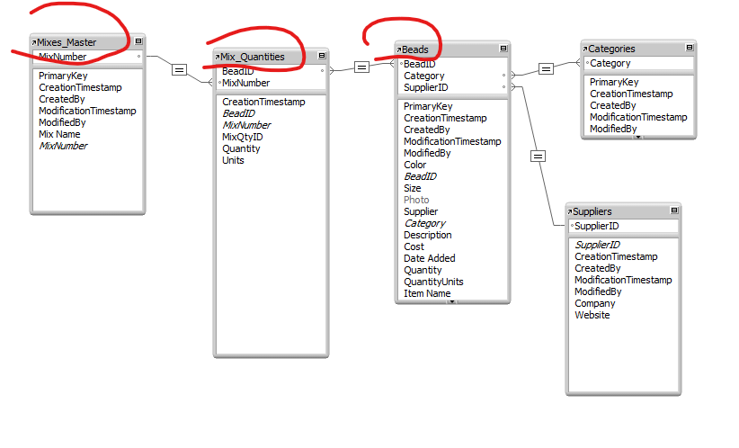

@commentThank you for sharing that. This is pretty much exactly what I want to do... I went back and basically adopted much of the same nomenclature to create my layout.  I'm 99% sure (only fools are really certain) that I have everything set up properly. I have three tables as you described in your recipes example: Mixes_Master (Recipes), Beads (Ingredients), and Mix_Quantities (Quantities). Each has a key field. Relationships are as shown in the screen capture.

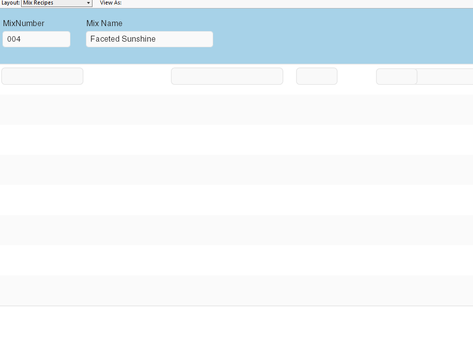

Where I'm losing my mind is when I look at my layout (shared both design and browse views) the portal doesn't even show up, much less allow data entry.

Although ... is that portal completely inside the Body part? Or is it "hanging" from the Top Navigation part? That would explain why you don't see it in Browse mode.
