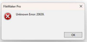

I am attempting to send an email in Filemaker with the following:
- Outgoing SMTP Server: smtp.mail.yahoo.com.au
- Port: 465
- Connection encryption: SSL
- Authentication: Plain Password
- User name: my email address
- Password: app password generated in Yahoo.
When I run the script I get an error - Unknown Error:20639 and when I click OK my Custom Dialog appears  stating The test email was sent.
My script is as follows:
Set Error Capture On
Send Mail
If Get LastError not = 0
Show Custom Dialog Email Failed
Else
Show Custom Dialog The test email was sent.
Obviously Filemaker is not recognising the error, to show the 2nd Custom Dialog.
Any help would be appreciated.

Thanks Comment,
Menu: Test Send Email
Set Error Capture [ On ]
Send Mail [ Send via SMTP Server; To: "[email protected]"; Subject: "Filemaker Test"; Message: "This is an email sent via smtp"; Name: "xxxx"; Email Address: "[email protected]"; Reply-To Address: "[email protected]"; SMTP Server: "smtp. mail.yahoo.com.au"; Port: 465; Use SSL; Authentication Type:Plain Password; User Name: "[email protected]"; Password: "xxxxxxxx" ] [ No dialog ]
If [ Get ( LastError ) ≠ 0 ]
          Show Custom Dialog [ Title: "Email Failed"; Message: "Error Code:" & Get ( LastError ); Default Button: “OK”, Commit: “Yes”; Button 2: “Cancel”, Commit: “No” ]
Else
          Show Custom Dialog [ Title: "Email Sent"; Message: "The test email was sent"; Default Button: “OK”, Commit: “Yes”; Button 2: “Cancel”, Commit: “No”]
End If
The error message is appearing (as shown in the image below) after running the script.
After I click ok on the error message, the Custom Dialog "The test email was sent" appears, which should mean that the email was sent, but nothing is sent.
I am puzzled.
From what I have read, such error can be caused by an antivirus program.
But I have no idea why the error message isn't suppressed by turning error capture on or why the error itself is not captured.
Thanks Comment,
I tried to send an email using File/Send/Mail and this worked correctly.
I then re-ran the script and this also worked, so maybe there was something in the File/Send/Email which overcame any issues???
Thank you for your assistance.
