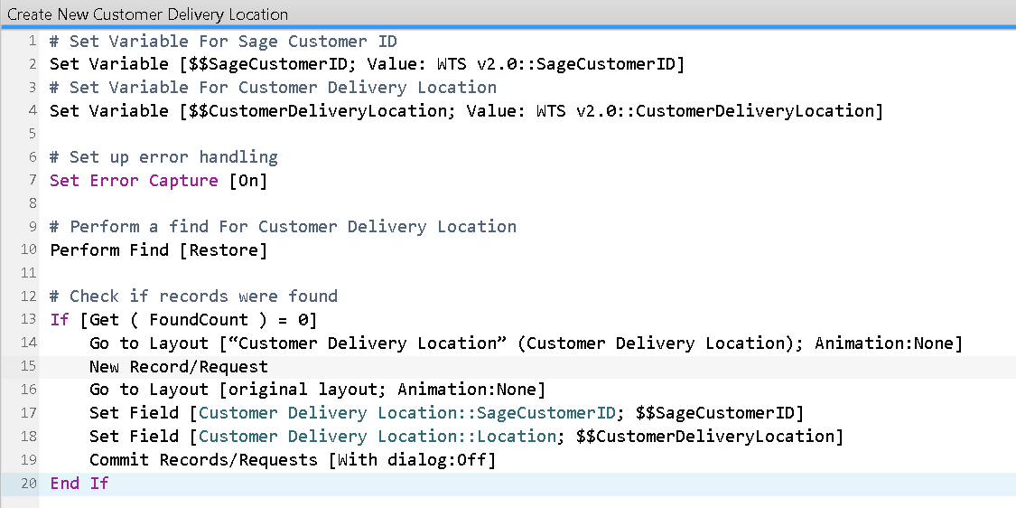

When a user types a ship-to location in the customer table and the record does not exist in the ship-to table, I want the record to be created automatically in the ship-to table.
This is what I have, but I have two issues.
1 - Once executed, it locks the layout, and I have to press Show All
2 - If the location exists in the second table, it creates a blank record
What am I doing wrong?
Any help is appreciated, or am I trying to do the impossible?

Thank you, I've settled on using a button and card to create a new location.

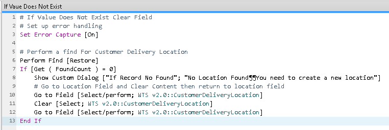

Now I am trying to create the following script, but I can't get it to work
The idea is that once a user enters something in the field, it will check if the entry exists in the database. If it does not, a message should display, letting the user know that the location is not valid for creating a new one.
I have the script executing on exit.

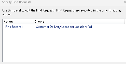

The simplest way to check if an entry exists is to perform a find. I see that your script does perform a find, but I do not see the stored criteria. It is also not clear where is the user's entry. I would expect to see a variable being set to the user's entry and this variable being used as the find criteria.
That being said, I still think there should be no need for such find. The process should start by user selecting from existing entries. Then, if they did not find what they need, only then they should make a new entry.
Thanks, this is my criteria.
The field in the main table, using a dropdown, if the location does not exist, the user has the option to create a new entry using a new window
