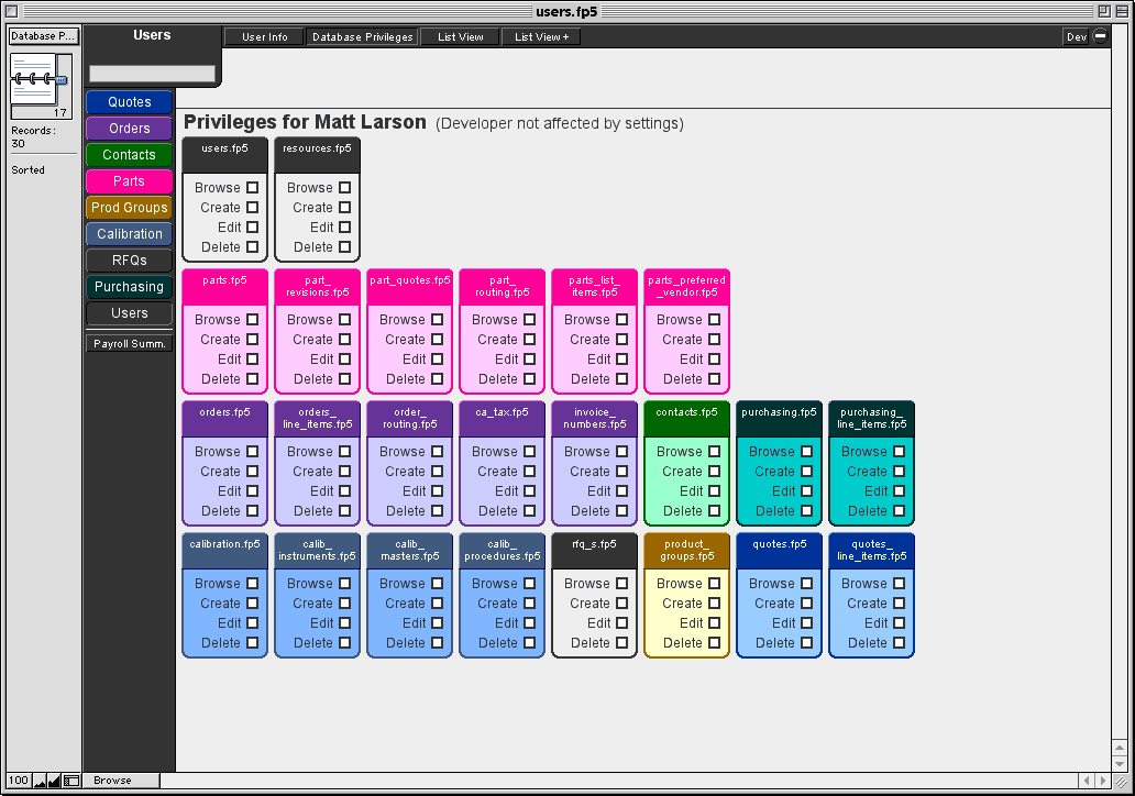

You can see the solution I chose in my Starter Template in the Sample Files forum... I built my own user/password system such that it is a proper *single* database and such that I can get reliable user names when recording audit trails. It was largely adopted from a textbook solution... so you can even get the accompanying textbook-quality explanation of the system.
Is it protected by FileMaker Security as well?
Is my solution protected by FileMaker Security as well? Yes... though the normal user won't see it.
Basically you default through FileMaker Security to the normal user password that has most everything turned off... and then I explicitly provide everything I want you to have, gated by my security system. By holding option as you open the DB, you can put in the only other FileMaker password... the master password, to enable all the built in menus and such.

My user system does not implement groups, per se; rather it implements individual Privileges. But you can think of Privileges as groups, where users can be in as many different groups as you want... where each group is independent of the other groups. But if you just want groups, you can implement them using Privileges.
