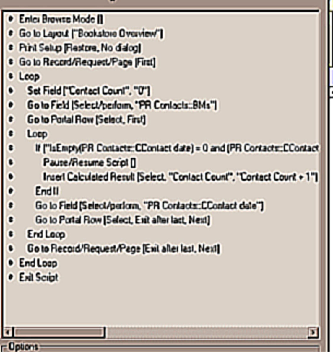

Hi. I using FMP 5.5 for a screen with 5 portals. I want to work with records in one of these portals, looping thru the records. The loop runs forever - so I'm either stuck on row one of the right portal or I'm not looping on the intended portal.
I think I'm making the right portal active by Going to the leftmost Field in the portal and I think I'm looping thru the rows of that portal using Go to Portal Row(Select, Exit after last, Next. This command preceds the End Loop.
Does Going To a portal field make that portal active? Does it stay active until if/when you Go to a different portal? Does FMP lose track of what portal it was using if, within the loop, non-portal fields are referenced?
Any thoughts would be appreciated.

If you have 2 or more portals on the same layout and the portals have the same field that you access with a GoTO Field, you'll have problems. If you want to go to portal B, you should use a GOTO field that is specific to portal B. If necessary, add a unique field and hide it by making it very small and non-enterable.
Thanks for further responses. I think that I'm staying on the right portal. I'm testing with a script that does nothing but counts portal records per master record. Most instances of the portal have only one record and the script works fine, moving to the next master record after counting the single portal record for the prior master record. When it gets to a master record with 2 portal records, it counts the first, moves to the second portal record, counts it, but then doesn't recognize that that was the last record in the portal. It just sits on the second record, and counts and counts.

Hi. I don't want to count the portal rows, I just using that as a test. I want to look for certain characteristics in the portal rows and I'll add this logic if/when I can get the basic process working.
Attached in the current script (in jpg -sorry for the poor resolution). PR Contact is the related file for the portal I'm starting with. I've tried every combination of Go To Field's trying to get FMP to stay on the right portal and on the right row in the portal. With the pauses I can see the progress, and as the preceding posting said, when it gets to the first master record with more than one portal row, it properly gets down to the second row and then begins to spin its wheels. My suspicion is that it keeps going back to row 1 just before it gets to the Go to Next portal row.
I tried using Go to portal row based on row number and came up dry. If it is possible (and intended that you be able) to work with the set of related records in a portal, I reckon I don't understand why it isn't straight forward. Maybe it is, and I'm just missing the magic bullet.

Scrolling through portal rows is slow and, if there is more than one portal on the layout, not very robust or reliable (as you are finding out).
Most people are (gently) advising that you should forget scrolling through the portal and instead loop through the records in the related file. I tend not to be so gentle: do it. It's much faster and more relaible and it won't unexpectedly break if you (or worse, somebody else) changes the layout with the portals on it some time in the future, not realising it's gonna be mission critical.
Jason Wood posted the basics of a script to perform the magic: give it a try. My 2c might be something like this:
