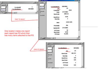

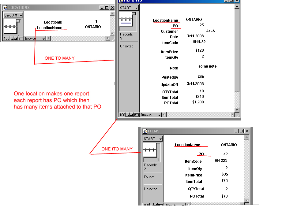

here is an image of the tables...please take a look...this is jsut an idea....meaning any suggestion on changing things arround is More than welcome smile.gif
My goal is to end up with these results:
Location Name | QTYtotal | POTotal|
ONTARIO | 3| $1200
LA | 2 | $800
NY | 5 |$1000
soo....
This is cleare now.
Then Location.fp5 is your "Product file", Report.fp5 is your "PO File" and Items.fp5 is your "Line Items" file.
There is a one to many relationship from "Locations" to "Reports", that's why you need a join file. Your "Item.fp5" File.
This Item.fp5 file, being a join file, would not be seen by anybody. It's the main file of your system but nobody should work directly on it (at least this is how I work). But also being a join file, this is the file that hold allthe informations, so all "reports", prints,... would be set from this file.
Now, go into your Report.fp5 and create a portal linked to the Item.fp5 using the PO#. Set this poral to allow creation of related records, and you will start having a real relational database, entering the locations to the Item.fp5 using this Portal.
Locations would be choosen from a value list of all locations from the Location.fp5 (use the format value list, use value from file Locations).
Now, if your goal is to see who purchased Ontario, make a portal into the Location.fp5 and use a relationship to the Item file to have a list of all PO'S that has Ontario in it. With some more time, you will even find a way to filter the whole Location file to see any records, customers, PO, invoice,...
If you need some more steps, I'm right behind you ...

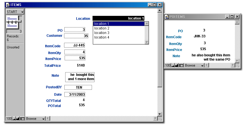

I do need people to work on Items.fp5 because I would have people insert data into Reports and then IF any aditional itmes go with the same PO I would have the users(insert for them) Update the Items.fp5 file assuming that PO got inserted automatically when they were typeing it into Reports.fp5..makes sense?
by the way this all is intended for CDML use not the by use of FM

in the DB you donated to me smile.gif ...can a NEW PO be generated without having to create the Customer first in Customer.fp5?
[ my idea was: have Customer Name (and ID) entered on Reports.fp5 along with the NEW PO and have Customer.fp5 file Look-up those fileds rather than the other way arround?!]
What i want to do is put this sys. on-line (CDML) and have users genereate new Reports but without really creating a whole new Customer Account...just the neame...but it seems that then the totals do now workout unless the Customer already exists. Can this be done so I have only one form on AddReport.html where I can use In-line to insert the same (CustomerName) info into 2nd DB although it is a look-up field?
I know it all sounds funny but I hope you get my idea
