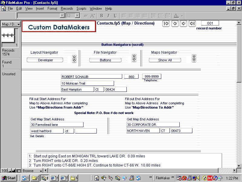

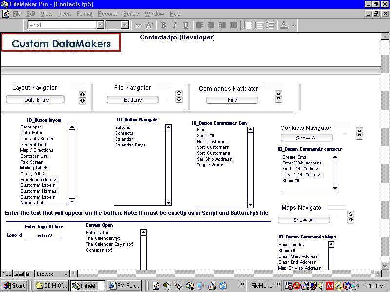

Hello Ernst
This is what I did to reduce portal rows to one.
The problem I had is it was not resetting the counter.
Fields =
gLayout_portal row number =number
gLayout_portal row = count(Relationship,somefield)
Script =
Up_Layout Portal_Rows
If gLayout_portal row number > gLayout_portal row or gLayout_portal row number < 1
Set Field gLayout_portal row number , 1
Else
Set Field gLayout_portal row number, gLayout_portal row number + 1
Go to Portal row (by field value) gLayout_portal row number
Go to Field (relationship, somefield)
For Down_Layout Portal_Rows (script)
changed
Set Field gLayout_portal row number, gLayout_portal row number -1
See the screen shot attached
Hi Robert,
Nice layout. Did I see correct that you built a routeplanner in Filemaker? Or is it pasted data?
About the script, are you sure you have:
In that order? I would expect the order to be reversed...
Anyway, if it ain't broken, don't fix it!
Regards,
Ernst.
Thanks for nice on layout 8-)
Yes Script is as is have 5 different for 5 different portals.
key is checking counter against calc = count(Somefield)
About Map planner
got a files from DB Pros called Maps.fp5
Incorporated his idea with mods to get maps and directions from mapquest.
(had to modify his fields , some did not work.)
anyway I can get map only, Map to address or map from address. work great.
Thanks again to Bob Weaver
See the Developr Layout Attached
