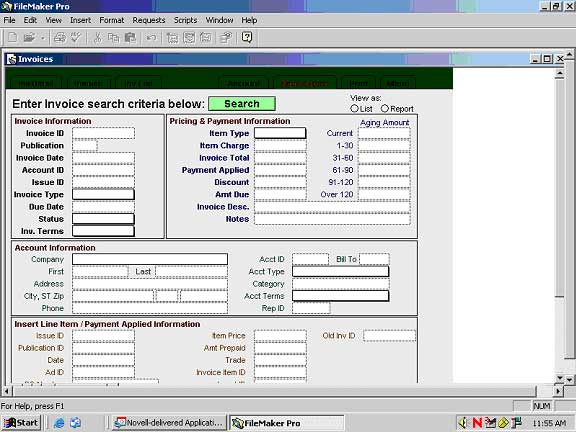

Is this a video card problem or what?
This is strange -- check out the attached screen shot. At the top is a green box, drawn in FileMaker. Overlaying it are some tabs, which are again just FileMaker buttons. They should be solid gray, but instead appear as nearly invisible outlines! Any ideas?
Could be a resource issue. I've seen much worse when running low. Try rebooting. Dialog buttons also have the tendency to turn invisible when low on resources.
Thanks, -Q-. Anyone else seen this sort of thing?
Update: it turned out to be a problem with the video card driver. Installing the driver from the Windows 2000 cd fixed it.
Edit-->Prefernces-->Application [layout] color pallete
or driver of video got busted
