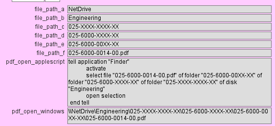

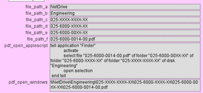

Thanks to suggestions from this forum before, I was able to create exactly what you're looking for without plugin help. You basically need a predictable file path (either on your local computer or a network). Then, create two calculation fields; one for Macs (using AppleScript) and one for PCs. You can then have your script detect if the user is on Windows or Mac using the Status(CurrentPlatform) function, then use the Perform AppleScript (Mac) or OpenURL (PC) on the resulting calculation field.
Take a look at the screenshot of the fields in my database. The part number of the current record is "025-6000-0014-00". You can see how my folder structure is laid out on the "NetDrive" network volume. I can post the calculations for the fields if you like.
Oops, here's the attachment.
I should also mention that I have not tested this in Mac OS X. We have yet to migrate our Macs to OS X.

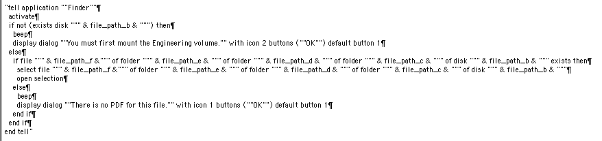

I revised my AppleScript calculation to account for common errors on the Mac OS (not having the "Engineering" volume mounted and the absence of the requested PDF). Here's a screenshot of the calculation that actually works with AppleScript (note the multiple quotation marks where needed).
