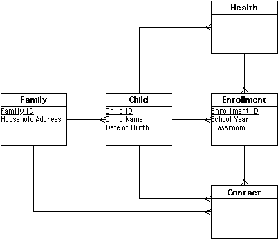

I'm not sure what your Client table is for, but the other parts of your project sound familiar to me. I have an enrollment solution that has the Familiy-Child-Enrollment tables set up exactly as you described (See ER diagram.)
For additional tables, think about each entity carefully, and how it may relate to each of the other entities. This is not a trivial process, so take your time and ask co-workers questions about how the process works (or should work.)

You're not being unnecessarily complicated. What you're describing is real world data that will require a complicated solution to properly track it. My Child-Enrollment system is around 30 files with tons of fields, scripts, and layouts.
You might hire a developer to get the basic structure built for you, then you can continue to add things as needs arise. If you are determined to do this yourself, take FM training courses and continue to learn as you develop.
The KID is what needs to be tracked. And this can get complicated, Nancy. Services provided, eligibility, etc. is usually based upon the KID address (and other criteria) within date spans so I suggest you have an Address table to track the KID movement. It would contain KidID, kid address, ParentID and start date. The ParentID (primary person responsible) must be based upon one PERSON. If that ID was originally attached to dad and the family splits, a new ParentID should be created for mom if the kid goes with mom. This will ensure tracking by allowing dad
In my solution, it made more sense to put the address information in the Family table (a family record is people living together at the same address.) This way if the family moves, the address only needs to be changed in one place.
If a family separates, usually the children stay together with one of the parents. If the children are separated and still attend the program, another Family record must be generated and the new Family ID must be attached to the old children.
I mostly agree. However, if the address most applies to the KID and the address is attached only to the kid, it's only entered in one place. The Parent address can then be accessed from the Address file (on ParentID) - also depending upon date. Which parent was responsible 6 months ago? With the populations I've worked with (mental health), the children are frequently split between parents. Attaching the address to the KID therefore makes more sense from my perspective. One Kid, one parent living here ... another Kid, another parent (or guardian) living here, etc.

Each file should have its own ID numbering. It's not really important if they start with a letter or not; that could be useful to users but the database won't care (so long as they are defined as text.) You know you have siblings because they share the same Family ID.
