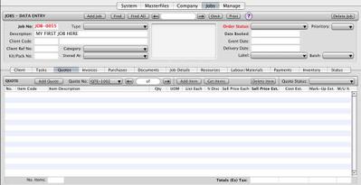

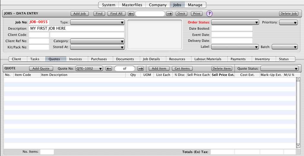

I am working on a DB Solution that is PROJECT BASED, You create PROJECTS ( JOB ORDERS) in the MAIN JOB FILE and then you add various other info through different tabbed layouts which appear under the JOB INFO at the top half of the layout, for example You add a job, and then related to that job you can add many Quotes, Purchase Orders, Invoices etc.
Each JOB ( Project ) can have more than one INVOICE, QUOTE or PURCHASE ORDER, I have Set Up the Relationships so far using the "SEPARATION METHOD" and the Table structure as such..
JOB ORDER ---> INVOICE MAIN ---> INVOICE ITEMS
JOB ORDER ---> QUOTE MAIN--->QUOTE ITEMS
JOB ORDER ---> PURCHASE MAIN--->PURCHASE ITEMS
On one particular layout ( Which is set to JOB ORDER) as the current table, I have a "PORTAL" of Items that belong to the "QUOTE ITEMS" Table for example. I wish to display the QUOTE ITEMS from Different QUOTE ORDERS that are created for a particular JOB ORDER.
I have a "POP-UP" list ( Above the portal) which can display the QUOTE NUMBERS for a particular JOB ORDER ( Project) so that I can filter the QUOTE ITEM RECORDS in the Portal.
I have a Button that says "CREATE NEW QUOTE" on this layout
My question is..
How do I make script (linked to the button "CREATE NEW QUOTE"), that can add a "NEW QUOTE NUMBER" in the related QUOTE MAIN table from this layout?
FM7 will ONLY allow you to add "NEW RECORDS" to the main file! ( in my case the JOB ORDER Table). How Can I tell FM7 to ADD a New QUOTE ORDER to the QUOTE ORDER TABLE" using a script?
I have attached a sample of my layout for viewing.
