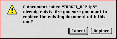

She double clicked on the one she wanted to open and the dialogue box said "Such-and-such database already exists. Do you want to replace it?" and she clicked YES thereby overwriting the existing database by creating a new empty database with the same name!

AFAIK, your data it gone, and you will have to create everything from scratch, unless of course you have been in the practice of backing up your files regularly, in which case just copy the backup into your folder and impute the missing since the last backup.
It might be worth a shot to try and recover it through a utility such as Norton, or Techtool, but I wouldn't count on it. If you want to try this, do it quickly before anything else gets written to the disk. Between you and I, I think you would have been better off if they had put the file in trash, and emptied the trash.
I wouldn't waste my time contacting FMI, you have just learned a very hard lesson about computers. Murphy's Law, whatever can go wrong, will go wrong, the only variable is in the timing. Usually that happens when you are least prepared for it.
So the lesson is. Backup your files regularly. You should always have a clean and current backup of your files. Institute procedures to prevent this type of preventable loss of data from happening in the future. Training is an area that this person needs to start with first.
Anyone that can click there way through a warning like this, needs to be severely reprimanded and participate in the re impute of the missing data.
