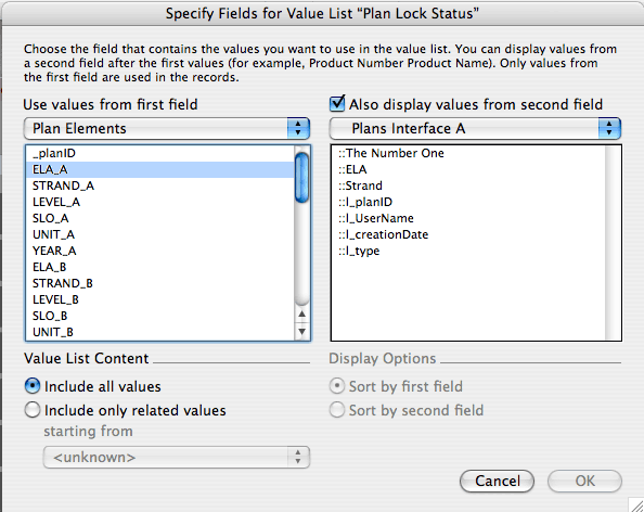

Is this screen shot helpful...? When you define value lists from a field you can set it to gather info from two fields...
You will need to define the two value lists. You will need a new calculated text field Combined Value List that is a concatenation of two ValueListItems joined by a paragraph mark. Use this field for your value list.
I don't think you will be happy with this if you have many Insureds and Sellers.
Oh yeah... duh, god I'm thick, and never used that option before too...
Ralph's thoughts are much more coherent....
just as well I haven't given up my day job!!!!
