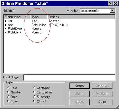

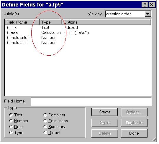

But what is the field type? "Text"? "Number"? Or is it "Calculation"? Because if the field type listed in the Field Definitions dialog is not "Calculation", you're barking up the wrong tree as RalphL suggests. See attachment for clarification.
