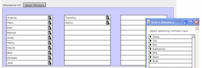

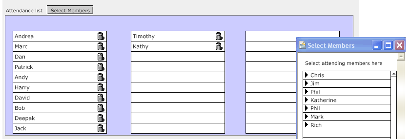

I used it in the FMPug database to show members who attended the selected month's meeting.
I did not want to have a scrolling portal, nor a portal that extended further down the page than was initially viewable.
So I added 3 portals side by side with 10 rows. The first portal is initial row 1, second is 11 and third is 21.
See attached image for example.
