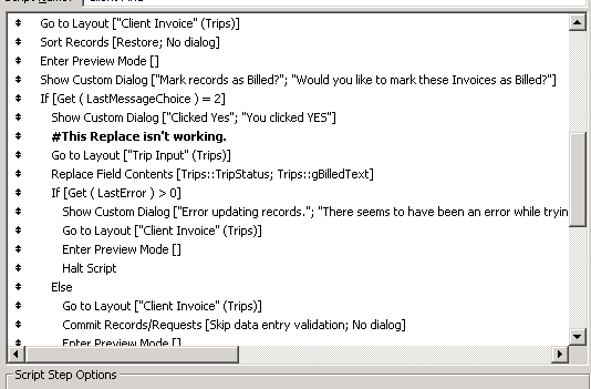

Okay, I have attached a .gif screenshot of that script portion since I can't cut-n-paste script elements.
I'm fairly certain that you can't replace records in preview mode. Try either eliminating that or going to browse mode for the replace portion.
Merlyn383:
I don't actually enter Preview mode until after the Replace is performed. Before the Replace is called, I only specify: Go To Layout [TripInput (Trips)]. Maybe it's possible that I am in still in Preview mode from the last call to Preview?
Could be. I will try your fix.
Merlyn383 - right on!
I WAS still in Preview mode from last call. Switched to Browse and the Replace executes just fine. Many thanks. I would never have caught that!
