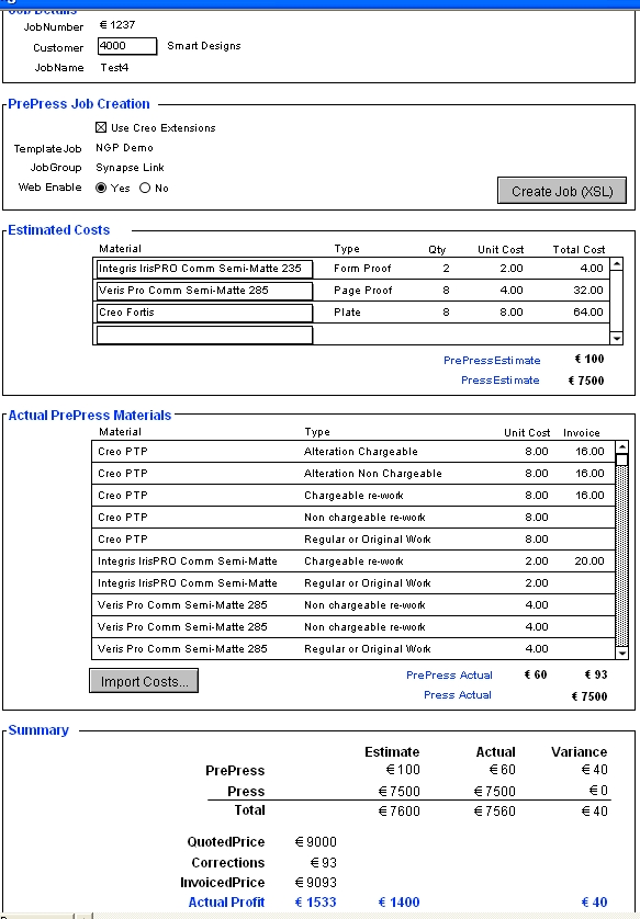

thanks a lot queue. that's exaclty waht I want EXCEPT, I need it as part of a form (see attached screen dump). In the second portal, I need to get the summarized values. i have a primary key in the related table, which is a concatenation of worktype and material and that's what i need to subtotal
So the last 3 visible lines should be grouped intoa single entry with Qty 3 and total costs.
Any suggestions?
Regards
mark
I'm having a difficult time visualizing this. Could you attach a stripped-down sample of your file, with a few sample records I can play with?
Hi Queue
So attached is my DB. Basically, I want to summarize the job costing (subtotaled by "key"). If you look at job number 1234, you wil see (on the job summaries layout) that "Creo PTP" "regular or origial work" is listed 5 times, but I want a count of how many listings and the subtotal of cost
Regards
mark
