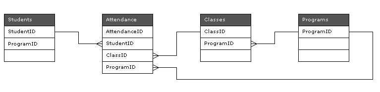

Steve,
i thought about Summary fields too. Basically i have a field call H_missed for hours missed and i have another field call Classname which save the T1...T8 and A1...A8. Basically, i want to know what it is the total hours of Techniques(T1...T8) a student have have missed and the same goes for Anatomy (A1..A8). i just want to find out what the total hours student misssed for the class. I want to know what is the total hours of techniques they missed.
I have included a diagram to give you overview how my database works.
I think you need three files: 1) student 2) class date 3) join. Each record of the join file will contain a student-class date. Then it's just a matter of putting the summary field (total) from the join file on the student layout. (I'm working with v. 7, so hopefully this will work with v. 6).
