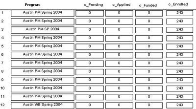

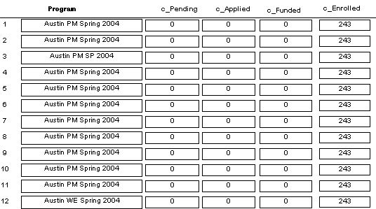

QuinTech,
Thanks for the info. I endup changing the way i did the counting. here is what i did.
Basically, i create two Calc field for each status.
I have:
c_Pending=If(Status = "Pending", 1, 0)
c_cnt_Pending=Total c_pending
So i did that for each status, it work fine. now, i need to break those numbers by Program.
Basically i have around 15 program going under Drop list.
Now for each Program, i need to find out how many total there is for each status. i got part in which i can find the total for each status but i need to match it to the program basically.
it would be Something like this:
Austin Spring AM 2004, Pending 0, Funded 4, Enrolled 5, Applied 10
Austin Fall AM 2004, Pending 2, Funded 3, Enrolled 6, Applied 15
Here is attachment of the DB.
Is c_cnt_Pending a summary field? If not, make it a summary field equal to total of c_Pending. Then make a subsummary part when sorted by Program and put the fields you currently have in the body into this subsummary. Sort by Program, go to Preview mode, and there you have it.

Quintech.
it didn't work for me with teh summary report. the c_cnt_field are summary fields. i still need figure out how to break down without doing a preview mode.
I want to see a report in layout like this:
El Paso Fall WE 2004, Pending 1, Funded 5, Enrolled 10, Applied 5
Thanks for all you help.
