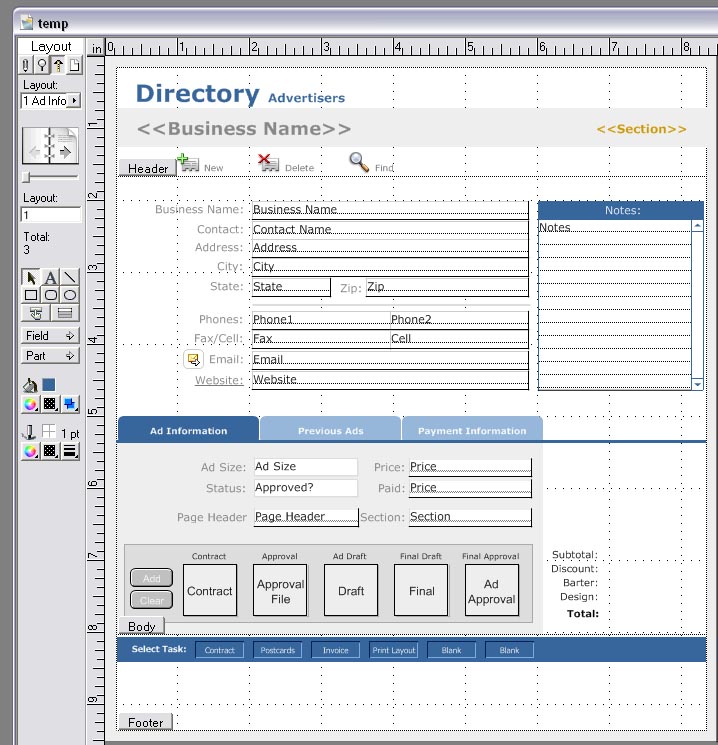

Attached is a creen shot of what i am playing with now, this is the general idea of what i am trying to do.

What barbaras posted is what i am looking for, except i want them to be calculations to keep track of sales, invoics etc. like i said above.

Just add those fields, honestly, shouldn't take more than 30 min. Most could add those in about 5 min. I know what you are thinking, you like the look of the template. Don't worry about the GUI (graphic user interface) now, that can be done anytime later. Infact, the one you have, looks like it is based around the customer. So you could use start with that file and add those other tables I said above.
I put a little thinking in the pic you should me. It is the same thing, but what you will do, is, through portals, show the information at the bottom. you still need to keep track of what items that company/customer has purchased and payments they have made. If you wanted the invoices to compound, and have the customers make payments on the total balances of all invoices, then you can see you will need another table that will keep track of payments for combined invoices. Again, it doesn't matter what you call it or what it does. You have to ask yourself, what is the center of that table. Then, what relationship does that table have to the others!

Can the old table and GUI (the one i posted earlier be used as the lineitems table? (still not sure what that is yet).

I would actually use the picture you posted for the customers table. The lineitem one you don't hardly ever look at. It just stores all the data of that sale into one record.
