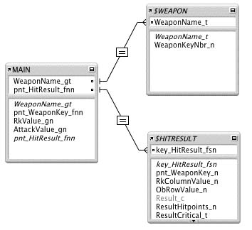

I have 3 global fields, two of them numeric, one text. The text field points to a related table (this table is in a referenced file); this table returns a numeric key corresponding to the text. An unstored calculation in my local table returns a numeric value from this key and the two numeric globals. The calculation result points to exactly one record in another related table (again, that table is in a referenced file). Fields from this table (one of them a container, but I do not think this is relevant) are shown in the same layout as the globals.
What happens is this: Whenever I change any of the 3 global fields, the calculation result changes accordingly (and correctly). However, the related record is displayed only if I change any of the two numeric fields; when I change the text field, the calculation re-evaluates, giving the correct pointer to the table, but the display does *not* change. If I then change one of the numeric globals (to the same value it had), the correct related record is shown.
I attach the relation diagram (sorry if this seems a stupid, not-too-serious example, but it is an FP7 dexterity training I do for my role-playing friends before I attack anything really serious for my boss). The text WeaponName gets the numeric WeaponKeyNbr that goes into the calculation of pnt_HitResult. pnt_HitResult is correctly calculated and displayed whichever of its source values I change; the correct line from $HITRESULT is *not* shown when I change WeaponName.

I get the same problem if I do away with the calculation and build the db with an FP7 multi-key relationship.

You will need a Refresh Window [Flush cached join results] script step since your HitResult relationship is based on a calculated field from a different relationship involving WpName_gt. It will work, however, if WpName_gt is not a global.
Thanks for the solution- right, it works perfectly the way you say. Seems I have lots to learn yet...
Hi again
pnt_WpKey_fnn could also be a global lookup field, which removes the need to script anything if it's important that the fields are globals???
Good call! An auto-enter calculation with 'Do not replace existing value for field' deselected works nicely also.
