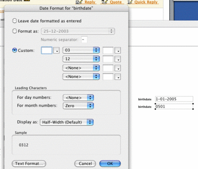

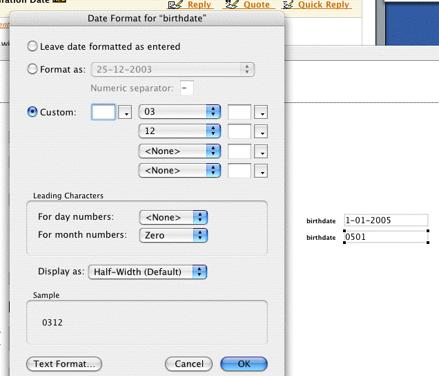

I suppose I could just convert to standard date but then I'd have to create a calc to convert back to MM-YY format
No, you wouldn't. You could use the same date field again, formatted as MM-YY, or YYMM, or whatever you like - see attached pic.
Silly that I forgot about field format for changing the date display - I've used it before too! blush.gif
I ADORE eliminating excess in my solutions. Thank you!!!!
