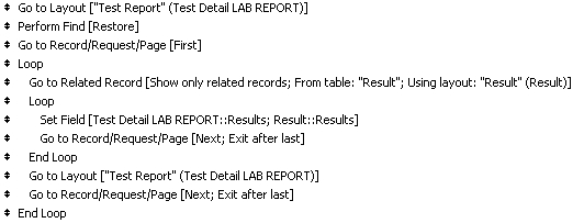

Well, you said you wanted to concatenate the related results into one field, which is what the concatenation step does, although if you want to display it horizontally, change the
Well, thank you for your explanation, it's almost there but still missing something...
Attached are my db, my relationships graph and my new version of the script.
It is written a bit simpler than you suggested but at least i know wht i'm doing smile.gif It works except the fact that it only fills in results for the active "test no" in the "Lab Report" layout
I think the tricky part in this is that in the "Lab Report" layout, it is 1 single record grouping all the "test no" but in the report >> "Test Report" layout >> it is multiple records...
Fyi, the perform find is not finalized yet but it should only find one record
and the result field on the report concatenate the 10 results fields (result1 &" , "& result2 &" , "& result3 & etc...)
On the latter part i have something that looks like a bug because when i put sample records to try, 1,2,3,4,5,6 works fine (displayed as such) but when i have 81,82,83,84,85,86 it displays 8.1828E+11 (but if i click into the field in browse mode it does shows the correct info frown.gif )
script.zip
Test Detail::Results is a number field. It should be text. 81, 82, 83, 84, 85, 86 makes no sense as a number.
