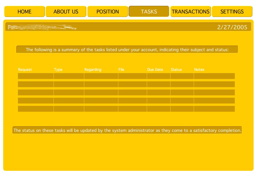

Okay, I tried everything and still couldn't find a satisfactory way to fix my problem. I attached a screenshot of my user interface (read only form-view intended for instant web publishing) with the empty fields indicating that I would like to display all of the records from the database for that user.
I cannot use a portal, since I am looking for records in only one table.
Help is greatly appreciated. I already spent way too much time on this seemingly silly problem frown.gif.
"I cannot use a portal, since I am looking for records in only one table."
Ahhh, but you can Hannah 24! With a self-join.
A self-join is a relationship linking a table back to itself. If you use a cartesian join (FMP 7) or a constant field (FMP 6 and earlier) you can display all records in the database in a portal on every record. Which I think is what you want to do.
However it has its challenges. One can be speed: if all records in the file are related to each record, then browsing records can be slow since FMP needs to keep displaying a huge list of related records... even more so if the relationship or portal is set to sort the records. No problem with 10 or 100 records but it beging to be notices when the record count gets to 1,000.
The second challenge is record locking in multi-user mode. FML locks the first row of the portal (related record) which can be a major interface bummer when there are more than one people browsing the file at once.

I created a self-join before, but noticed that it still displays only one record in the first row, and not all records across the specified range. Any way around that?
H
If all your records are in a single table (FM7) or a single database (FM4-6) then you can create a self join portal.
Quick Eg. three fields:
First Name, Last Name, City
If you use a portal with 'City' - 'City' as the portal relationship then use the other two Fields in the portal. This will display all the records who are located in the same city.
Dont use the City field in the portal because it is not necessary.
Swap the relationship to Last name - Last name and you will get all the users with the same last name.
Darren,
Thank you very much! This completely solved my problem, for I previsouly assigned more than the crucial ID-ID self-join relationship.
