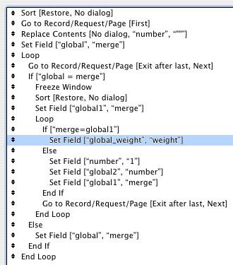

March 7, 200521 yr Author I have a shipping file that has a record for each customer purchase as follows: Record 1 Name: joe Smith Address: 45 J st Item purchased: widget 34 Weight 5oz Record 2 Name: joe Smith Address: 45 J st Item purchased: widget 57 Weight 10oz reimbursement Record 3 Name: joe Smith Address: 45 J st Item purchased: widget 16 Weight 5oz How can I determine the total weight for this customer when all three of the widgets are in separate records? I think a self join relationship would work somehow, or creating a new record with globals for the weights?? Attached is my work on the script to find the duplicate names I am close but I have hit a wall. Any help would be appreciated. Thank you.
March 7, 200521 yr I have a shipping file that has a record for each customer purchase as follows: Record 1 Name: joe Smith Address: 45 J st Item purchased: widget 34 Weight 5oz Record 2 Name: joe Smith Address: 45 J st Item purchased: widget 57 Weight 10oz reimbursement Record 3 Name: joe Smith Address: 45 J st Item purchased: widget 16 Weight 5oz How can I determine the total weight for this customer when all three of the widgets are in separate records? I think a self join relationship would work somehow, or creating a new record with globals for the weights?? Attached is my work on the script to find the duplicate names I am close but I have hit a wall. Any help would be appreciated. Thank you.
March 7, 200521 yr If you are using FM6, create two files. One for customers and the other for item purchased, weight, etc. The relationship should be based on a customerID number. Then it becomes easy. All you have to do is create a calc field that sums up the weight through the Customer to Purchases relationship.
