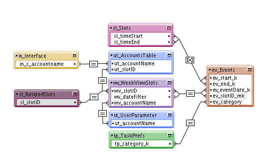

I will do a template as I'm sure I'd gain as much from your comments than from the exercice itself...
I didn't have too much time today to work on it, but as far as the tests go, it works the way I have imagined.
Attached is the graph of the solution if it may help. I will try to go into a template tomorrow.
A "SlotsTable" consisting in 24 records with SlotID, timeStart and timeEnd, provides an alternative to a common time range relationship.
Each of the accounts will have a set of 168 records automatically loaded into a "WeekViewTable", which consist in 7 days * 24 slots of one Hour. Of course, we'd be using the slotID from our "SlotTable" here.
The main Date Range keys are set into the "UserTable", as well as a timeSlot range in case you want to see mornings and afternoon separately, or if you want to show only 12 slots at a time, and slide from 00:00:00 to 23:00:00.
The Date and Time ranges, when populated into the UserTable are passed to unstored calculations into the "WeekView" Table, and from there you'd be targetting the events and appointments related to any Date and TimeSlot from your inputs.
In the "EventsTable" is a list of related slotID from the startingTime and endingTime of any appointment. This list, auto-entered is indexed.
A rather complex calculation in the "EventsTable" produces a multilineKeyCode that *quickly said" will allow to split any appointment into several quarters of an hour as well as several slots of 1 hour.
In the WeekView table is a calculation targetting and parsing this related multilineKey so that the result is a repeating calculation that will be used to split each slot of the portal into 4 quarters.
According to the event type is a colour and you will therefore get a clear graphical view of your week schedule into this portal.
If you need to see the file, I can mail it to you, even if it is obviously a draft at the moment.
I really don't know when I will have time to go into it any further, unless tomorrow is calm...
