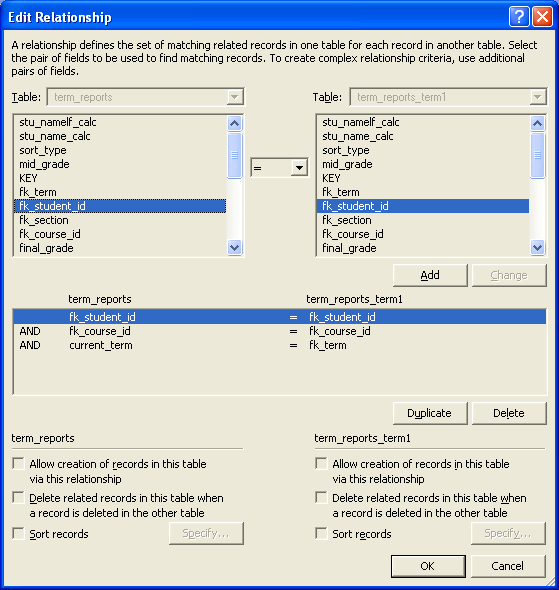

I apologize, but I don't understand. I made a layout based on my child TO (term_reports_term1). My main table has the global field current_term set to "1". I put a few fields on the layout (just for reference), but the total records is the same as my parent table (all terms). Based on the relationship from my parent to the child, I should only see term 1 in my TO(term_reports_term1), right?
I'm attaching a screen shot of the relationship. Where would I put a GTRR step to change my total records (found set)? I must be missing something obvious here. If I still don't quite understand, I'll just attempt some other method to solve this layout need. confused.gif

Go to Related Records[] is the script step you would use to jump from the parent table to the related records in the child table. Use the 'Show only related records' option, and set the destination layout to be the new layout based on term_reports_term1.
With this script in place, you can add a button to your layout that performs this script.
